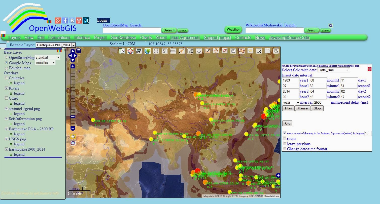

Map 1-The animated map of the earthquakes all over the world with magnitude 8 and more in 1900-2014 years. For this map the time interval for each year is set - 2500 milliseconds. For further information about this map you can read here
Animated maps in OpenWebGIS are understood as maps, on which there are layers containing the attribute with the date/time values and where with the help of the "Time Line" function is started the process of layer changes drawing according to date/time changes.

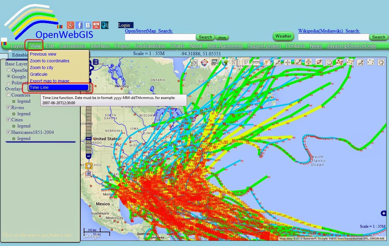

2. Click on menu item "View"->"Time Line", like it is shown in Figure 2.
Figure 2.

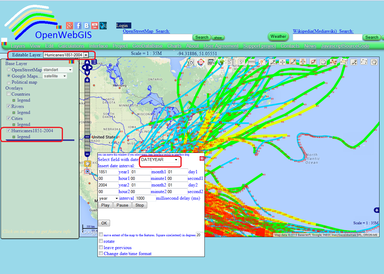

3. In opened popup window select the field (attribute) with date –(in our case the name of this field is "DATEYEAR"). See Figure 3. Dates/times in the field with date must be in format ISO8601:yyyy-mm-ddThh:mm:ss (for example:"1851-08-17T18:00:00"). It is necessary for animation in OpenWebGIS.
Figure 3.

Figure 1.2. Click on menu item "View"->"Time Line", like it is shown in Figure 2.
Figure 2.3. In opened popup window select the field (attribute) with date –(in our case the name of this field is "DATEYEAR"). See Figure 3. Dates/times in the field with date must be in format ISO8601:yyyy-mm-ddThh:mm:ss (for example:"1851-08-17T18:00:00"). It is necessary for animation in OpenWebGIS.
Figure 3.<div class="MsoNormal">
