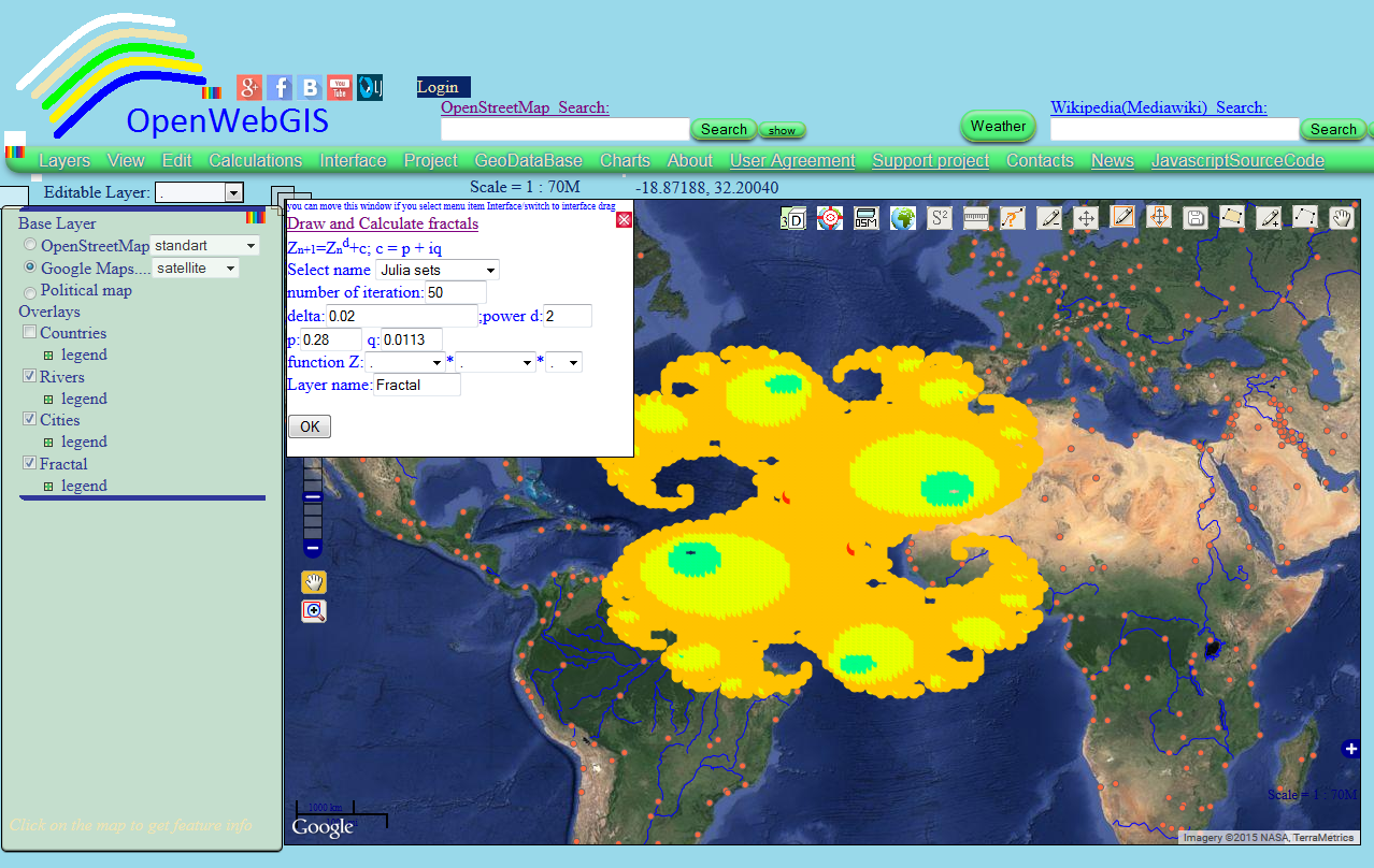

Example 2. The result of the fractal creation on the map is shown in Figure 2. You can read more about the fractal creation on the map in OpenWebGIS here.
Figure 2.

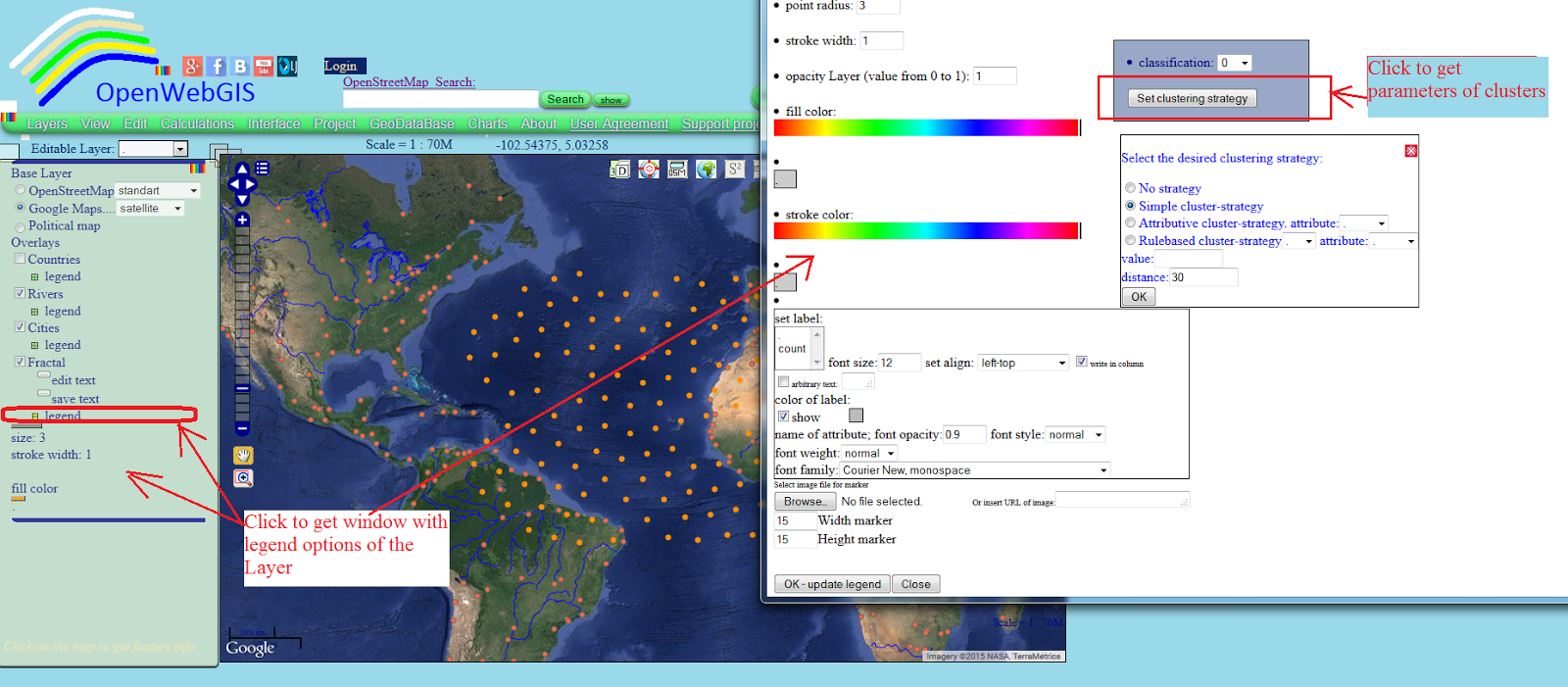

Find out how to create clusters and maps like Map 1 and Map 2. For it you must change the layer legend . To do this, click on the word "legend" under the layer name, you are interested in. Afterwards under the layer name the area will appear on which you click to open the legend settings window. Look at the Figure 3.
Figure 3. Notations in clustering settings (see Figure 3):
