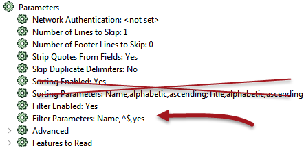

Rajesh Dhull: Rajesh didn’t do the extreme renaming I did, but his workspace did include one other change. Somehow I hadn’t noticed that the CSV reader has a parameter for filtering; use that and you can get rid of the Tester. Clever!
Rajesh also replaced the Sorter transformers by using a sort parameter on the CSV reader. That’s not so clever, I’m afraid. My original workspace sorted by neighborhood name, which isn’t part of the CSV. So I guess that means disqualification. Sorry. Without that his workspace checked in at exactly 70,000 bytes.

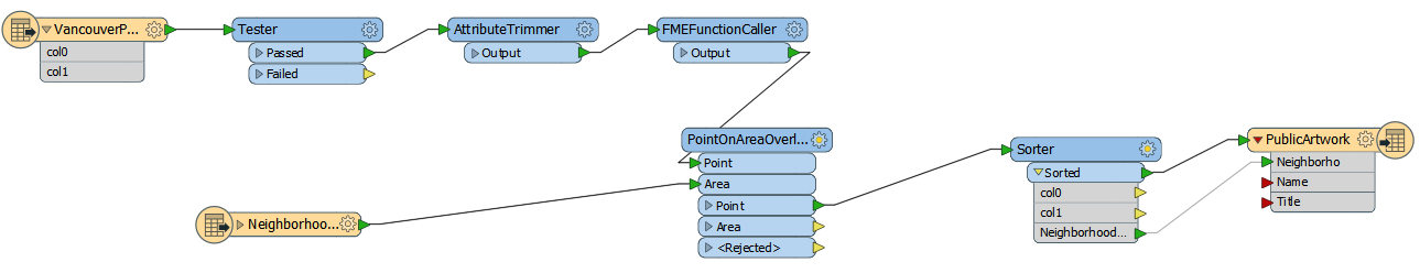

Todd Davis: Todd filled my email inbox with three attempts, each improving upon the previous. His final workspace used a Generic Reader to read both source datasets. I hadn’t thought of that. It certainly saves a reader but at the cost of requiring extra transformers. He also replaced the AttributeRenamer and VertexCreator with an FMEFunctionCaller that called various functions such as @CopyAttributes. That’s fine. I did say functions are in the rules.
But what’s most remarkable is his file size: 35,229 bytes! That’s astounding. I’m going to try and replicate that because it is so much better than anyone else (so far…). His workspace is this:
