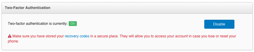

1. Activate two-factor authentication
If you care about security, you should really be using this! It adds an extra layer of security with no drawbacks (except that it takes you a couple seconds more to log in). We use the Time-based One-time Password Algorithm (TOTP), which can be used with different applications. The most popular one is probably the Google Authenticator (Google Play, App Store) but it is also the most basic. I personally prefer Authy (Google Play, App Store), which comes with an encrypted cloud backup. In case you lose your phone, the accounts can be restored on your new phone. If you prefer not to use a cloud backup, we do offer recovery codes in case your phone is unavailable.
Two-factor authentication can be activated in your Personal Settings.
Enabling two-factor authentication in FME Cloud.

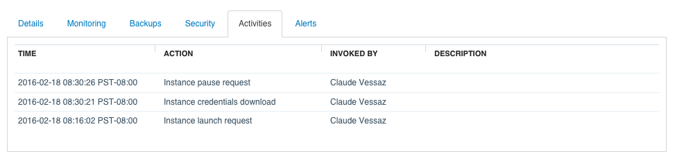

4. Monitor instance activity and login history
We keep track of pretty much every action taken against any instance. Want to know who downloaded the credentials? Check the instance activity. Wondering who paused the production instance? Check the instance activity. The activity log is most effective if you use it in combination with personal users.
You can review an instance’s activity log in the Dashboard by selecting an instance and navigating to the Activity tab.
If there was an action initiated against your user but you are sure it was not you, we also keep track of the last ten successful logins, including IP address and location.
Checking the activity log in FME Cloud.
Enabling two-factor authentication in FME Cloud.2. Create personal users in Team Management
Checking the activity log in FME Cloud.5. Treat the API token like a password
