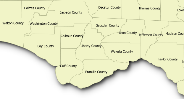

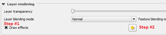

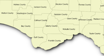

Live layer effects is probably the most talked about new feature and was crowd-sourced. It adds the ability for a variety of effects including a drop shadow. The creator of this feature has a great post and quick how-to. Basically, when you got to style a layer, look towards the bottom, check the "Draw Effects" check-box. Then, look a fair way to your right and click the 'yellow star.'
I found using this to be much easier-to-use than its implementation in ArcGIS.
It can be easy to overlook the Draw Effects check box when styling.
Adding effects is easy-to-do in QGIS and look good!Often, I feel my maps can get stale, or someone wants a more 'graphic' or photo-shopped look for a presentation, other product, or to develop a 'brand.' So having this feature is great, especially, if like me, you are not an expert graphic designer or cartographer. I look forward to seeing creative uses of this feature in the QGIS Flickr Map Showcase. There may already be a few in there!
