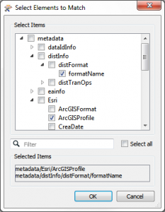

Working with XML Hierarchies
Understanding XML starts with presenting the data’s hierarchical structure in a straightforward way. In FME, the tree navigation interface lets you choose which XML node you want to become a feature type (or layer or feature class). Then the fields are auto-generated. Using the data in your workflow becomes simple — for example to create geometry out of lat/long and georeference the data points.
