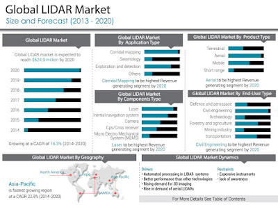

LIDAR is an important technology that is undergoing continuous and expansive growth and predicted to reach $1 billion by 2020. A recent report also describes ongoing developments in LIDAR in Europe. NOAA has a great one-hour Introduction to LIDAR that I recommend checking out: http://coast.noaa.gov/digitalcoast/training/intro-lidar
Source: Allied Market Research, https://www.alliedmarketresearch.com/lidar-market
