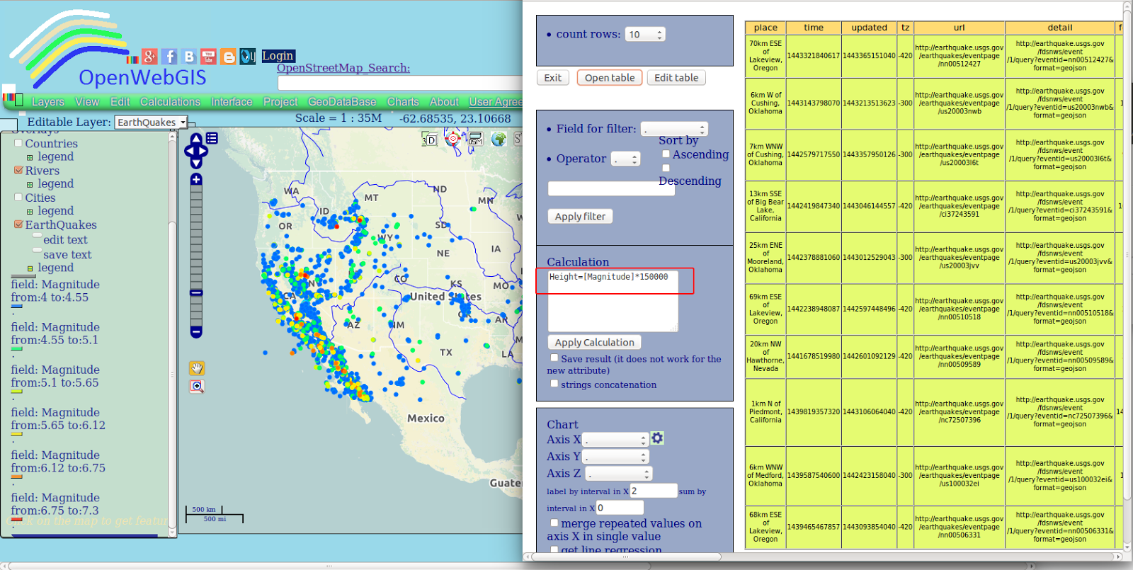

1. Select the name of the layer "EarthQuakes" in the "Editable Layer" list.
2. Open the attribute table using the menu item "Edit-> Open attribute table".
3. Create a new attribute for instance called "Height". It will be used to create 2.5D columns. Their height will be calculated in meters above ground level depending on the number of earthquakes in each square. Therefore, this attribute must be created using the formula (Height = [Magnitude] * 150000) shown in Figure 2.

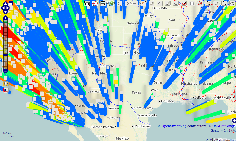

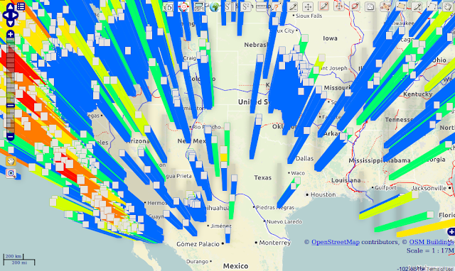

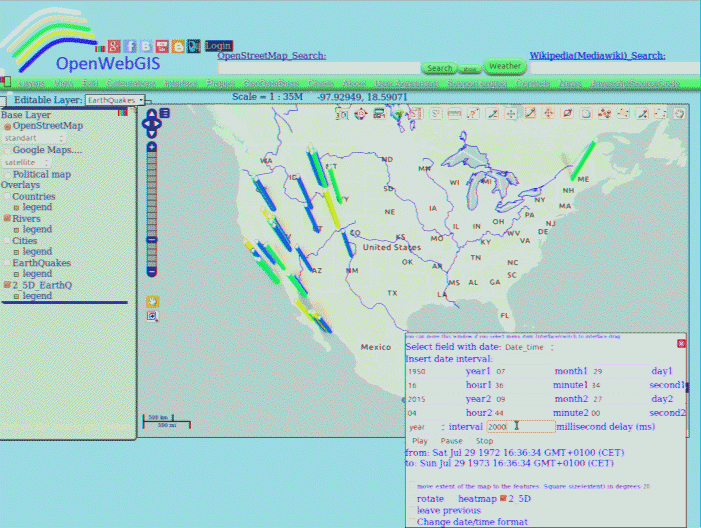

Then select menu item"View-> Time Line" and activate the option 2.5D (See Figure 3), then there will be a settings window of 2.5D columns. Set the options as shown in Figure 4. Press "Extrude" button and result will be like shown in the Figure 5.
