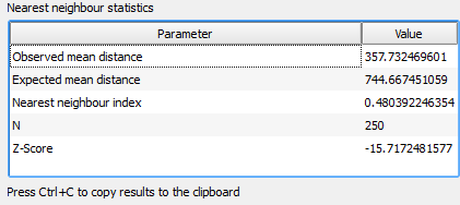

QGIS can calculate the nearest neighbor index to assess point clustering. No p-value is given but the simple trick is to remember that large negative z-scores mean the points are clustered while large positive z-scores mean the data is more dispersed.
No p-values are given but remembering critical values/decision points,i.e. +/-1.65, 1.96,
is the easiest way to know if clustering is statistically significant.Mean Center and Standard Distance

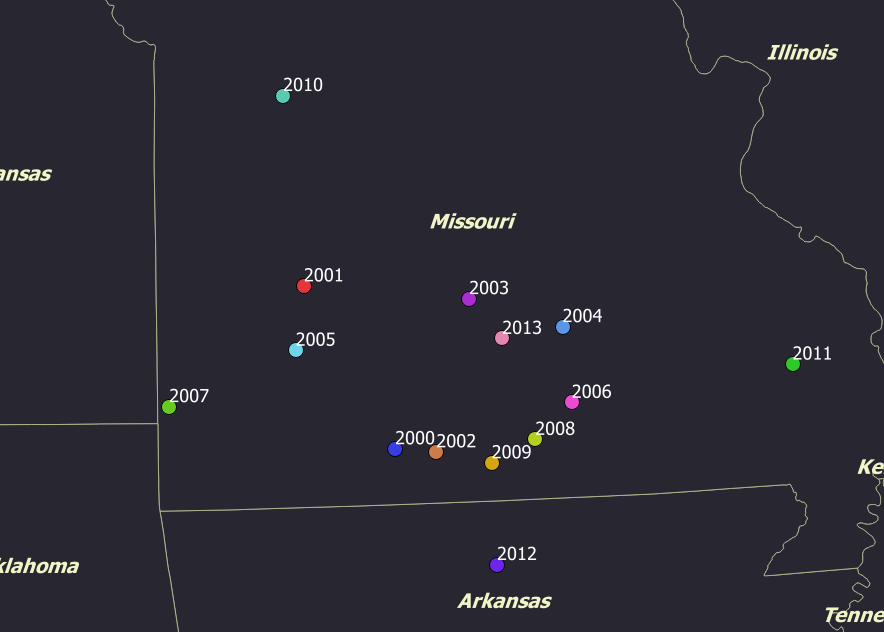

The mean center, an average of x- and y- coordinates, is an easy way to find the central feature and to examine spatial-temporal trends. In the case below, the mean of all starting points, by year, for US tornadoes, 2000-2013. The data are grouped by UID, in this case a year variable. It would be great to also be able to calculate a median center. Data source: NOAA Storm Prediction Center.

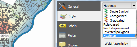

You can download the Heatmap plugin or use a built-in live/dynamic heat map when you go to style a layer. For the latter, make sure to move the rendering slider to 'best' for a nice looking heatmap. Here is an example using the dynamic heat map to look at homicides in Philadelphia. Data source: OpenDataPhilly. In future posts, we will also look at alternatives to heatmaps, like gridding/quadrat analysis.
QGIS has lot of neat options for styling vector data, including a dynamic heatmap
that changes as you zoom in and out. (Note: In ArcGIS kernel density tool (not to be confused with point density) remains separate from the base software and has to be purchased through the Spatial Analyst Extension).
- In some years, the average was pulled slightly west or east. Interestingly, the mean is pulled east in 2011, when there was a large 'outbreak' of tornadoes across the southeastern US.

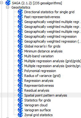

The SAGA Geostatistics Toolbox in QGISRipley's K
