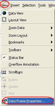

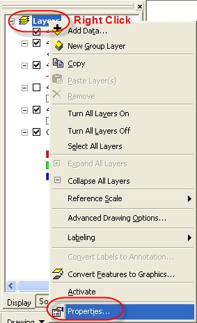

The user has two options to get to the Data Frame Properties.

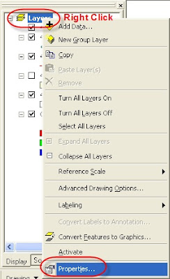

1. Right click the Layers heading, then in the ensuing drop down menu click
Properties.
OR:
2. From the main menu click View, then in the ensuing drop down menu
click Data Frame Properties.

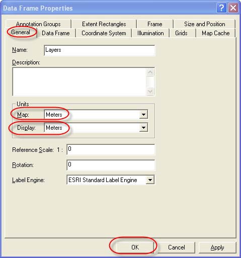

3. In the Data Frame Properties window select the General tab.
4. In the Units subheading select the desired unit of measurement using the
drop down arrow for both Map and Display. If the Map drop down
window is grayed out then only select the Display unit of measurement.
In this example select Meters for Map and Display then click OK.

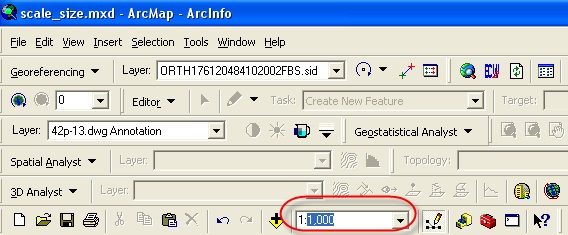

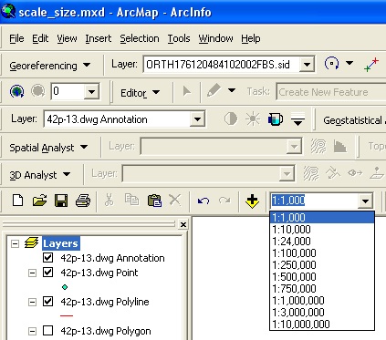

1. In the Map Scale text box simply type in the desired scale. Example:
1:1000. Alternatively, use the drop down arrow to select one of the more
commonly used map scales.

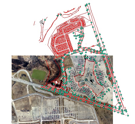

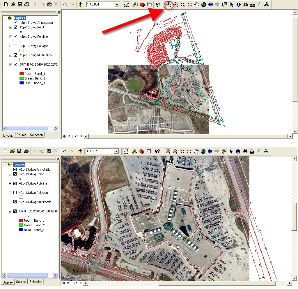

In this example we will focus on the image below which is an orthophoto
(Woodbine Centre Mall located in North Etobicoke) being co-displayed with a
property data map.
The goal of this example is to adjust the paper size so that the entire mall fills the
layout view at a scale of 1:1000.
1. Use the Zoom In icon located on the toolbar to zoom in to the desired
region. In this example, the target is the mall.

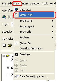

2. Change to a layout view by clicking View from the main menu and then
selecting Layout View.

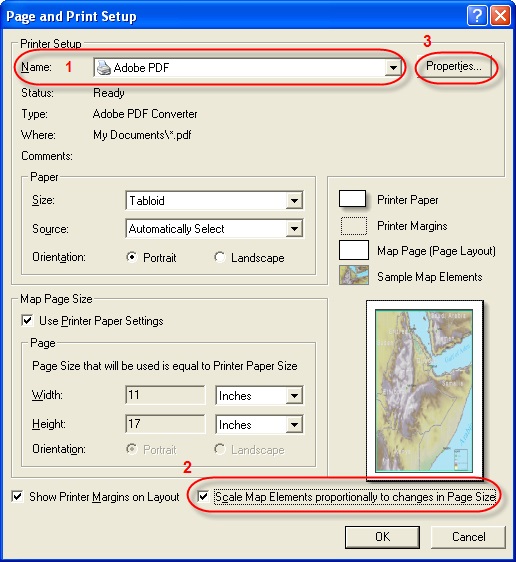

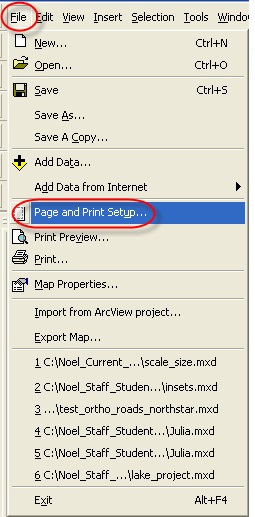

3. Once the unit of measurement has been selected (see Section A) and the
image scale has been set to 1:1000 (see Section B) click File from the
main menu then select Page and Print Setup in the drop down menu.
4. In the Name textbox select Adobe PDF. In the bottom right corner of the
window check the box next to Scale Map Elements proportionately to
changes in Page Size then click the Properties button.

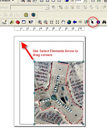

7. When the page dimensions were changed, the scale may have also been
altered, change the scale back to 1:1000. Use the Pan tool to centre the
image on the mall. In addition, you can click on the Select Elements
arrow to widen the image so that it fills the print region (see image below).
Despite the changes, as you can see below, the image does not capture the
entire mall at a scale of 1:1000.

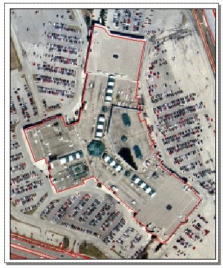

8. The solution is to add a few more inches to the width and height. Repeat
steps 4 through 7: Add three inches to the width and height (width = 14,
height = 17). If done correctly, your image should look like the one below.
In most cases you will not select the correct page dimensions on the first guess,
thus it is important to note that steps 4 through 7 may be carried out two, three or
more times until you reach an ideal page size.

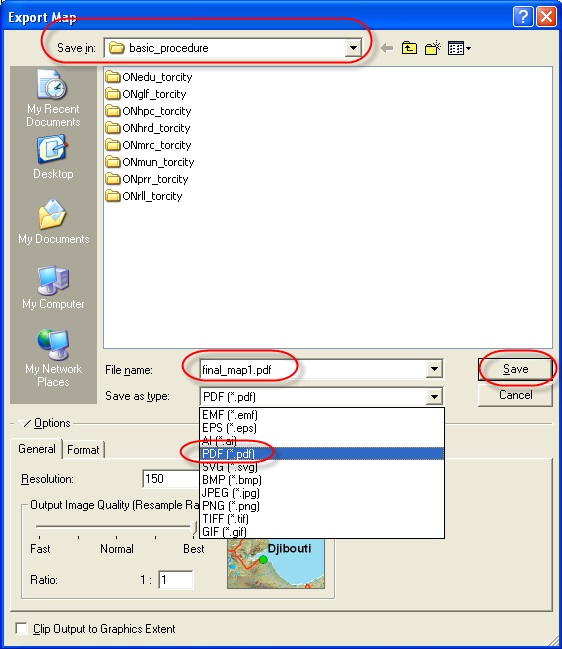

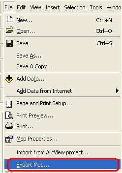

1. Once you have completed Steps 1 through 7 above or you are satisfied
with your map, you may begin the export procedure. Click File from the
main menu and Select Export Map.
2. The Export Map window will open. In the Save In window, browse to the
location that you wish to save your map. In the File Name text box, chose
an appropriate name for your map. In the Save as Type textbox select
the format that you would like to save your map in.
3. Click Save.

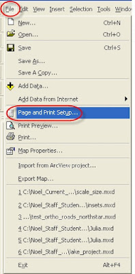

3. Click Save.
