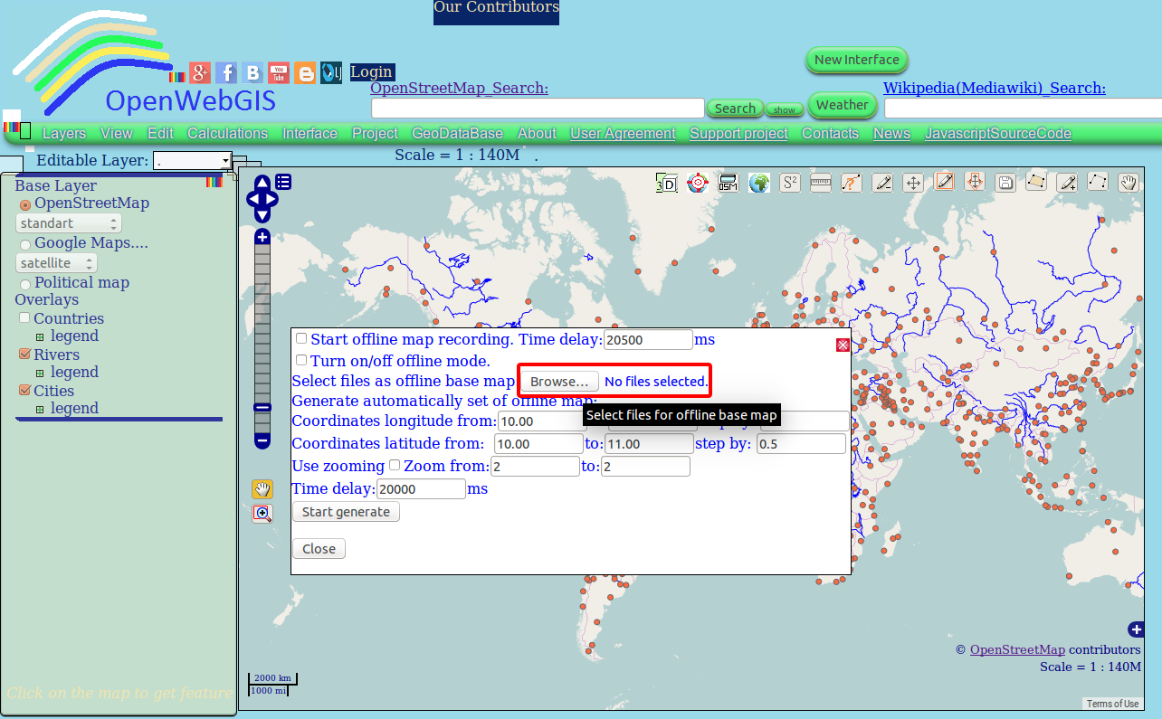

To access the work settings with offline maps it is necessary in the main menu select the item «View->Offline mode settings», then the popup window opens shown in Figure 1.

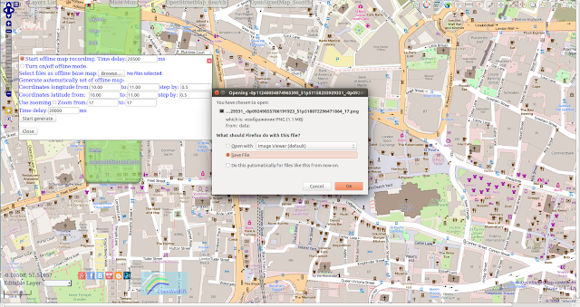

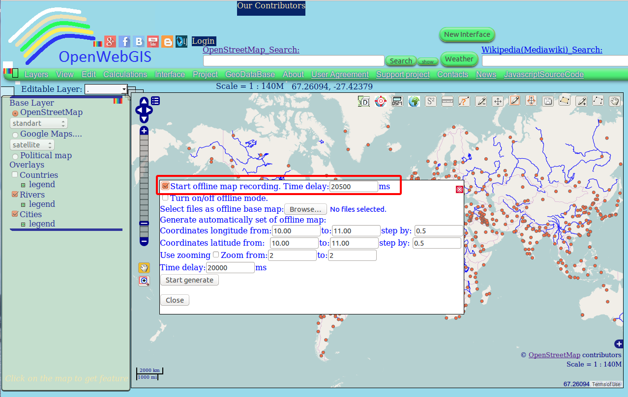

To start recording manually the base map it is necessary to activate the «Start offline map recording» option and to set the «Time delay» in milliseconds (look at the Figure 3).
Usually the slower speed of your Internet, the greater the time delay you need to install. The setting of Time delay is necessary because the creation (generation) of png offline map file is asynchronous from multiple (each time their number may be different) images (from each tiles URLs of a base map), each of these images is loaded with different speeds which are affected by many conditions, including the speed of your Internet, your CPU, the availability of the tasks performed by your browser at this time. Taking this into account to calculate the exact time of the full load of all the images according to the work algorithm of javascript code in OpenWebGIS is difficult. Therefore, the time delay, after which with a high probability an offline map will be ready for the user, is set by the user at this stage of OpenWebGIS development. If readers have any suggestions to optimize this code please offer - JavaScript code of this process is described later in this article.
Then you can close the «Offline mode settings» window and while every zooming and panning through the set Time delay you will be offered to download the map in png format, as shown in Figure 2. To stop this process - Deactivate the option «Start offline map recording.»
To start recording automatically a base map it is necessary first to set the coordinates of a geographical area of interest - longitude from ... to, latitude from ... to (indicated by the number 1 in Figure 4) and step in degrees (indicated by the number 2 in Figure 4).
Then it is necessary to set if there is the change in maps zoom and in which interval (indicated by the number 3 in Figure 4). Then set the «Time delay» (indicated by the number 4 in Figure 4). And finally press the button «Start generate». After this the user through «Time delay» will be given the opportunity to download a map (a tile of the map), which is generated according to the settings in a specified step in degrees. The step determines the shift of each next formed map from the lower left edge of the specified area to the top right edge of the specified area. It is connected with (an important point - please pay attention) that the size of each generated map in degrees and pixels corresponds to the size of the map window set by the user (the default pixel size is 1000 pixels in width and 600 pixels in height.) To change the size of the map window, click on the «additional toolbar» (look at the Figure 5).

After preparing the set of maps (blocks, tiles) for the offline mode, the user before activating the offline mode should select the files of generated maps (tiles) using the «Browse» button (look at the Figure 7), there is any number of files, in this case it is eight.
If you run OpenWebGIS on a device with Android OS, then at the moment Multiple file selection is possible in the browser «Google Chrome» . User must set the extent of the map close to the area which is covered by the generated maps, and then activate the option «Turn on/off offline mode.» (Look at the Figure 8).

To start recording automatically a base map after setting all the required parameters shown in Figure 4, it is necessary to click on the button «Start generate». After that the function Record_AutomaticOfflineMap() is activated. The essence of this function is that it provides an automatic iteration of the above described function recordOfflineMap() as many times as it will be required by the set extent of a user-defined geographical area for an offline map and the step in degrees by latitude and longitude to generate this map blocks:
{var numberofimages=0
for(var i=parseFloat(document.getElementById("longitude_OfflineMap1").value);
i<=parseFloat(document.getElementById("longitude_OfflineMap2").value);

Now let's turn to the process of offline mode activation. For this it is necessary to select files of generated maps (tiles) using the «Browse» button ( look at the Figure 7). There is any number of files, thus this button must have an attribute «multiple».
input title="Select files for the base map" type="file" id="folder_OfflineMap" multiple
Then there is a need to activate a checkbox with the title «Turn on/off offline mode.». This checkbox has id="id_startOfflineMapMode". An event of changing the state of this checkbox is bound with function OK_OfflineMap()in the following way:
document.getElementById("id_startOfflineMapMode").onchange=function()
{if(document.getElementById("id_startOfflineMapMode").checked==true)
{ OK_OfflineMap()}
else{globalVarOfflineMapOn=false}}
Here globalVarOfflineRecMapOn - is a global variable. The value (false or array of Images files) of this variable is considered during every panning and zooming of map. If globalVarOfflineMapOn!==false, i.e. the offline mode is activated and files are selected, then during every panning and zooming of map the function OK_OfflineMap() is triggered.
The files array assigning to this variable is done in the following way:
//event occurs while file selecting:
document.getElementById('folder_OfflineMap').addEventListener('change',readFolderOffMap,false);
function readFolderOffMap(evt)
{globalVarOfflineMapOn = evt.target.files; }
About addEventListener read here
