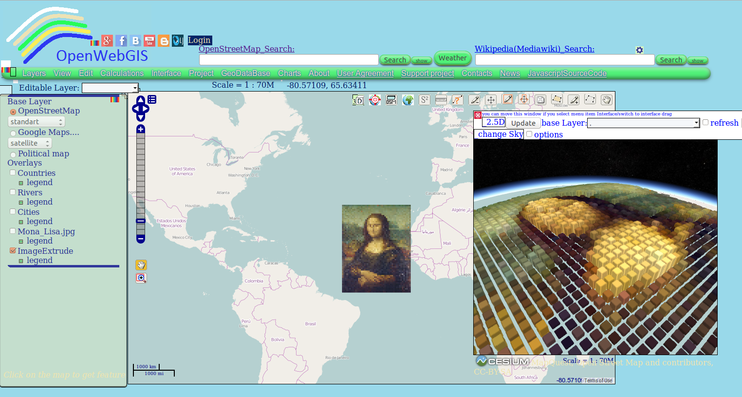

Put the painting to the map by using the menu item "Layers-> New Layer from Image file" of OpenWebGIS. For example, set the coordinates: lower left longitude: -41.4597656243041; lower left latitude: -0.41015632552055414; upper right longitude: -16.93828125271782; upper right latitude: 29.866050040550537. The result of adding this picture is shown in Figure 2.

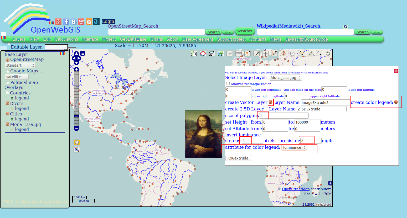

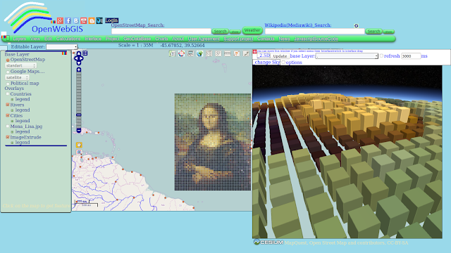

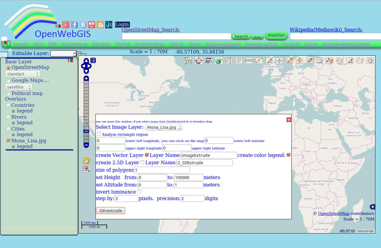

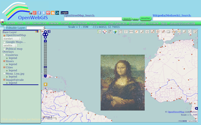

The interactive map with the added picture is available at this link.Then we apply the function "Edit->Extrude image". If you specify options for this function as it is shown in Figure 3 (be sure to activate the "create color legend:", then rectangles (squares) of vector layer will be painted in the real pixel colors of the image), then the result will be as shown in Figure 4.

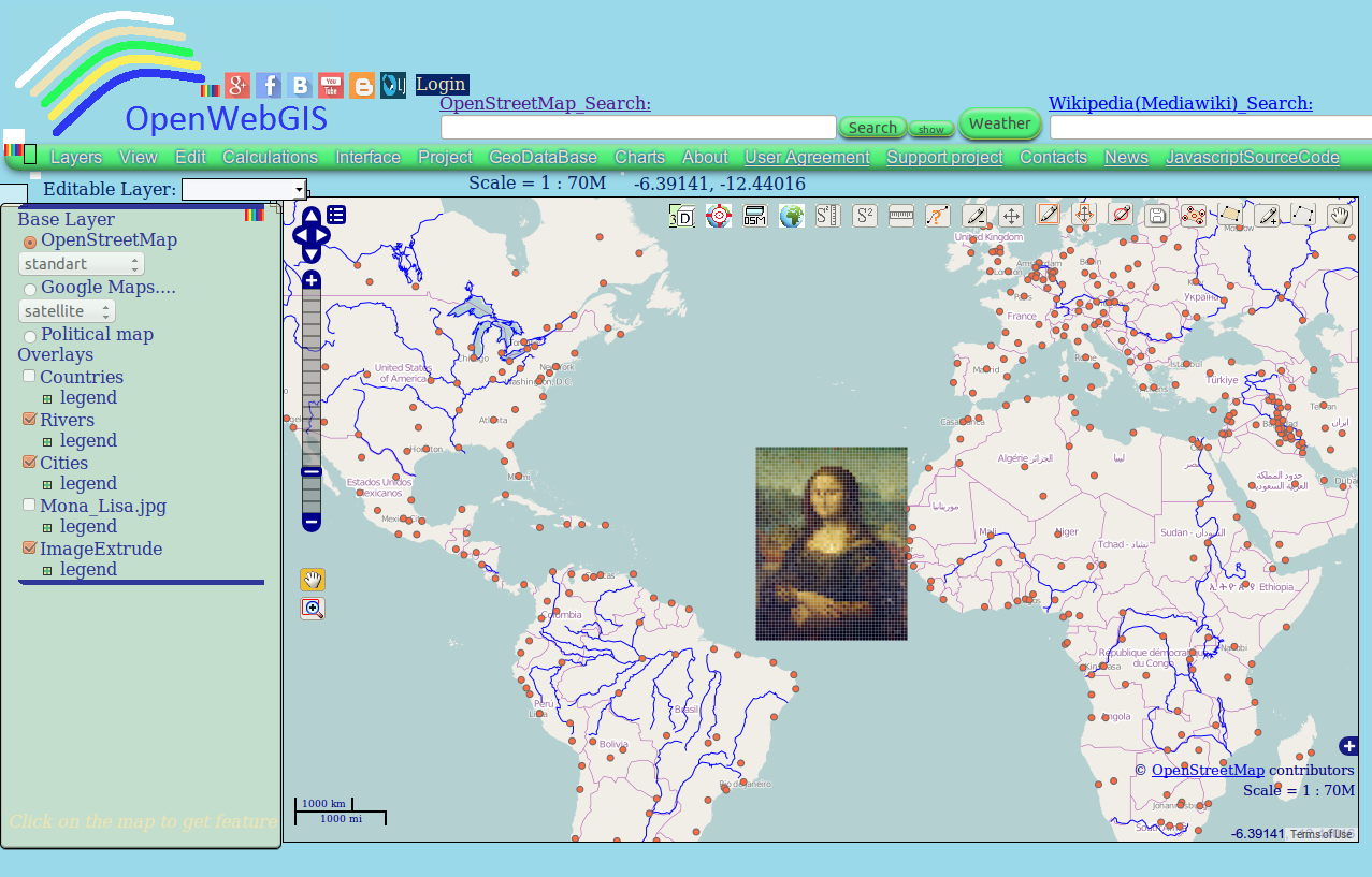

If zoom in it to some extent it will look like in Figure 5. The interactive map with the results shown in Figure 5 you can see at this link. Pay attention that loading this map can take a long time (it depends on the power of your computer).
Vector Layer will better reflect the contents of the picture, if in the option "step by: pixels" the step of calculating pixel will be reduced from 3 to 1. In this case every pixel of the picture will be analyzed, but the calculation time will increase greatly.

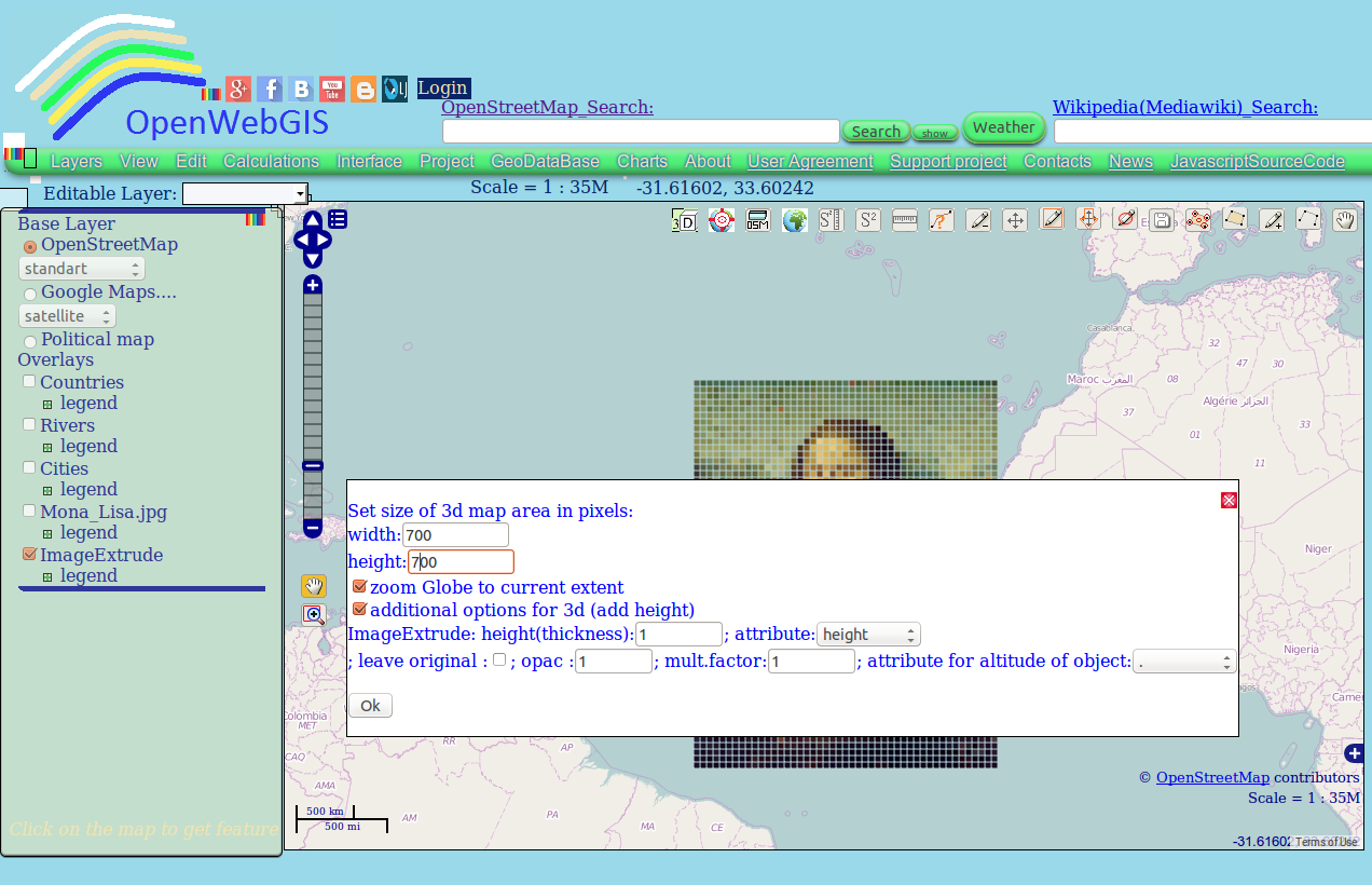

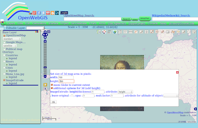

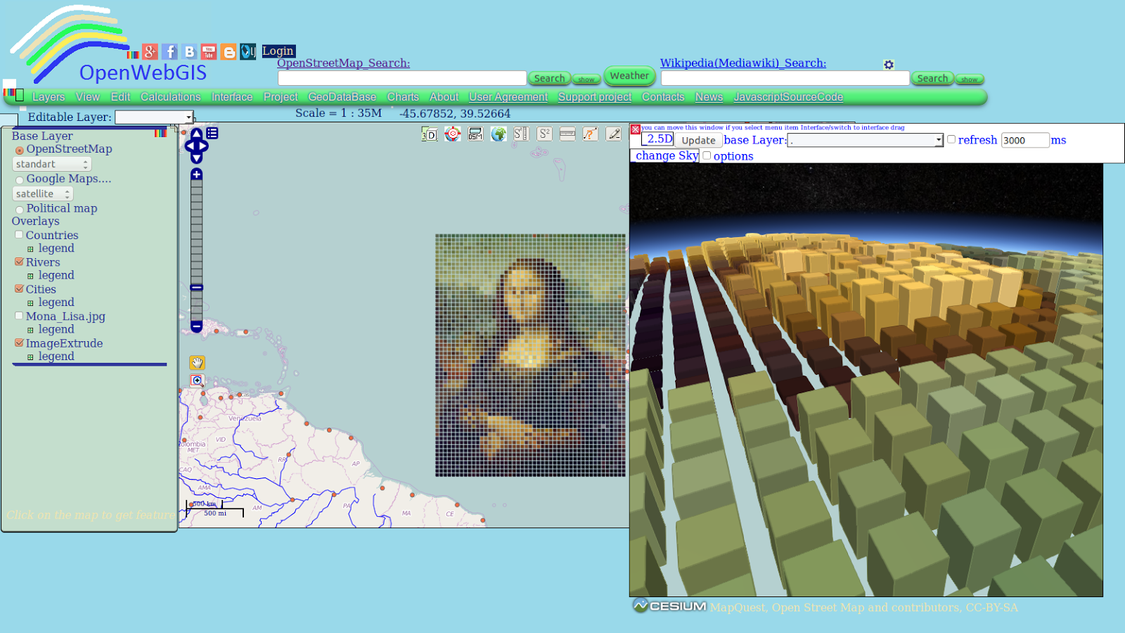

The results of the painting translation in vector format can be explored as a 3D view. Click the appropriate 3D button in the upper right corner of the map, in the pop-up window that appears specify the options such as shown in Figure 6.

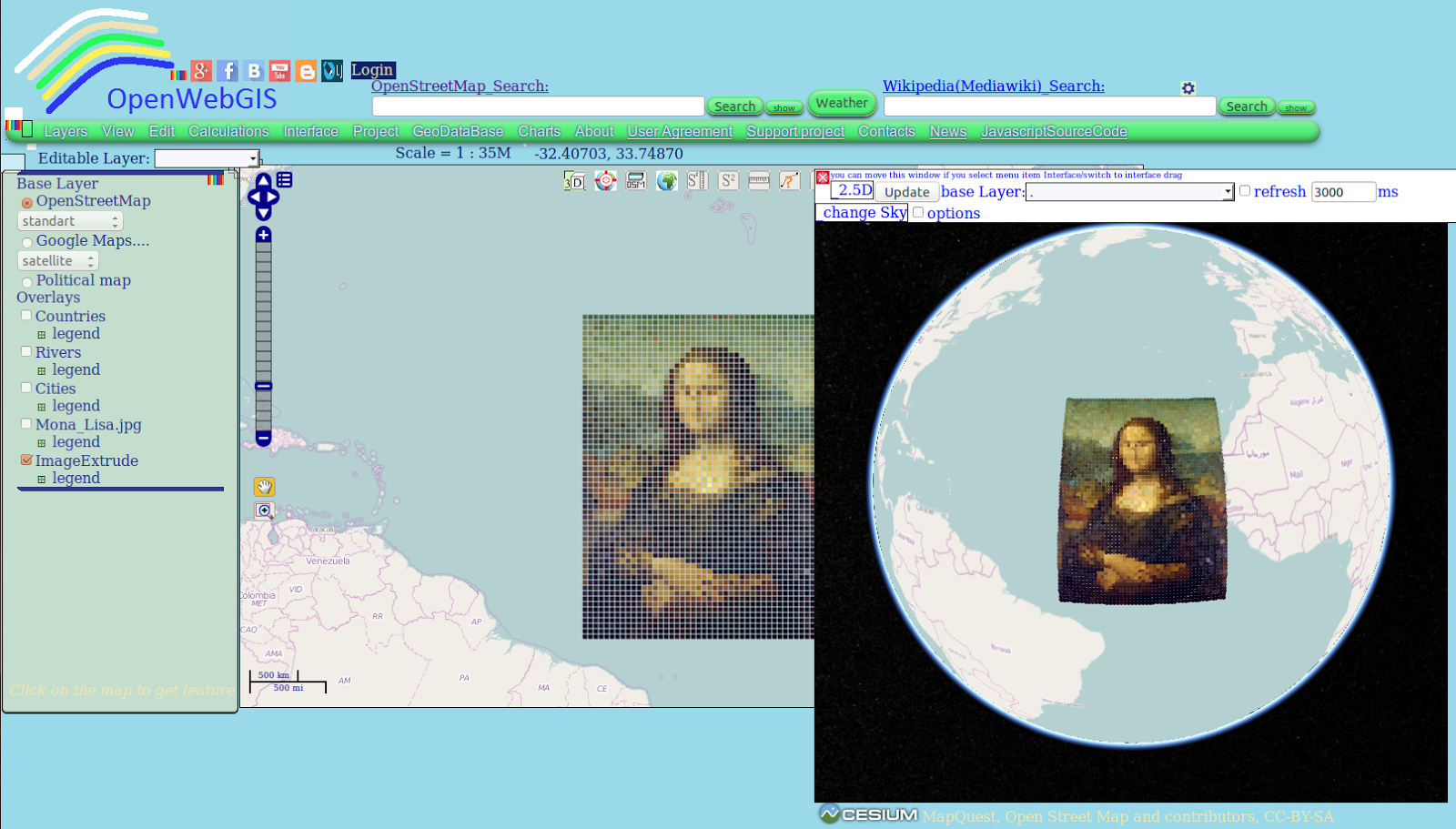

The results shown in Figure 7. If you rotate the 3D view and zoom it you will see what is shown in the Figures 8, 9, 10.
