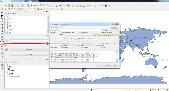

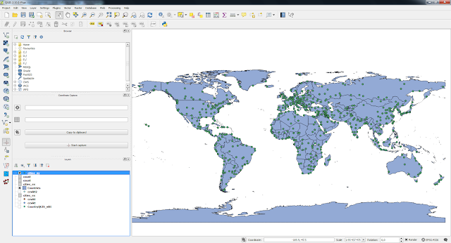

To add CSV with WKT in QGIS (assuming that the geometry field is called "WKT") it is necessary to use the button of adding vector layers that is highlighted in the left by a red circle in Figure 11.
