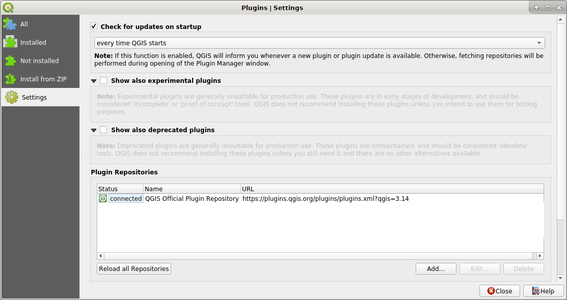

- Run QGIS;
- From the main menu, select Plugins > Manage and Install Plugins;
- Click Settings then click the button Add;
- Inside the Repository details enter:
- and click OK;
- After the repository update, the item Semi-Automatic Classification Plugin v6 - master should be listed with the other plugins;
- From the menu All, select the Semi-Automatic Classification Plugin v6 - master and click the button Install plugin; the version 6 of SCP should be automatically activated (in case restart QGIS);
