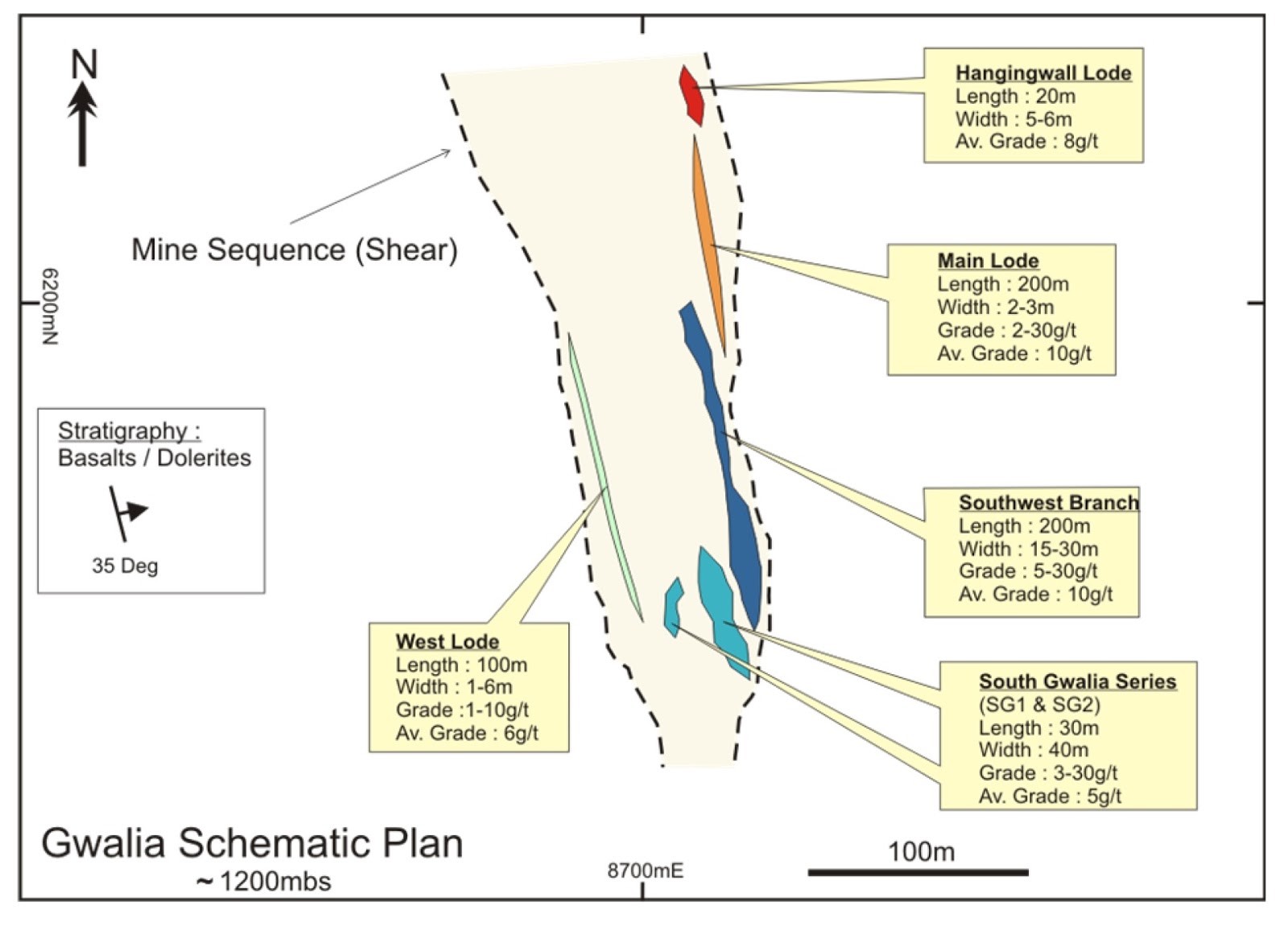

Gold mineralisation occurs as a number of en echelon, moderately east dipping foliation parallel lodes within strongly potassic altered mafic rocks and extends over a strike length of approximately 500m and to a vertical depth of at least 2,000m. Five lodes have been identified and the lode names and geometries are summarised in Figure 1 below. Further detail on the geology and estimation techniques can be found in the St Barbara Limited Mineral Resource Report.

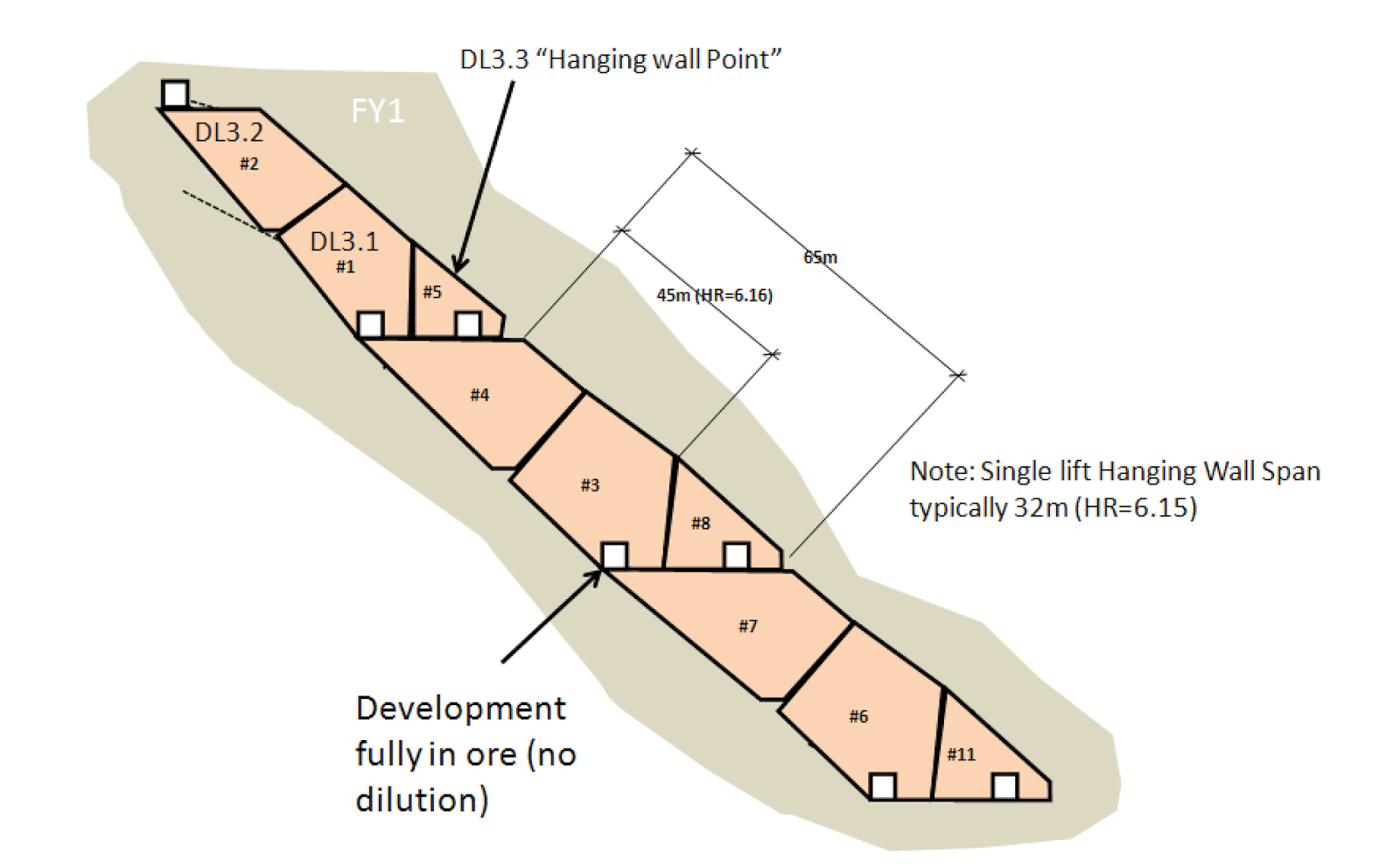

FIGURE 1 PLAN VIEW OF GWALIA LODESThe primary mining method since resumption of underground production in 2008 is a Longhole Open Stoping method with paste fill. Stoping configurations are predominantly double lift (40m vertical interval) however single lift stoping (20m vertical interval) is used in some areas. The Double Lift stoping method (as illustrated in Figure 2) involves concurrently mining the uphole (part DL3.1) and downhole (part DL3.2) sections of the stope. The upper and lower portions of the stope are drawn back and bogged at the same time. Parts 2 and 3 are then paste filled, followed by the delayed extraction of the DL3 part 3 wedge (part DL3.3).
FIGURE 2 SECTIONS OF DL3 STOPES WITH SEQUENCE MARKEDThe delayed extraction of the part 3 wedge serves to reduce the hanging wall dip length in the primary stopes and thus preserve HW stability despite the 40m vertical lift. The installation of HW cables and the use of a concurrent strike retreat blasting sequence of the part 1 and 2 sections, also assist in controlling HW stability.

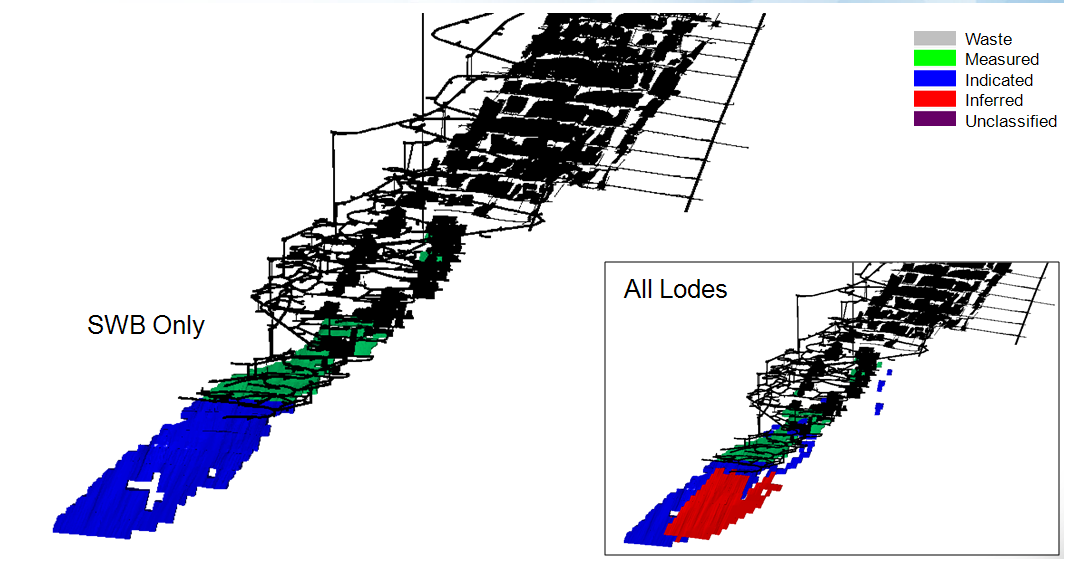

The declared Reserve is based on the current Life of Mine plan for the Gwalia Deeps deposit. Figure 3 shows the Life of Mine design colour coded by the reserve classification.

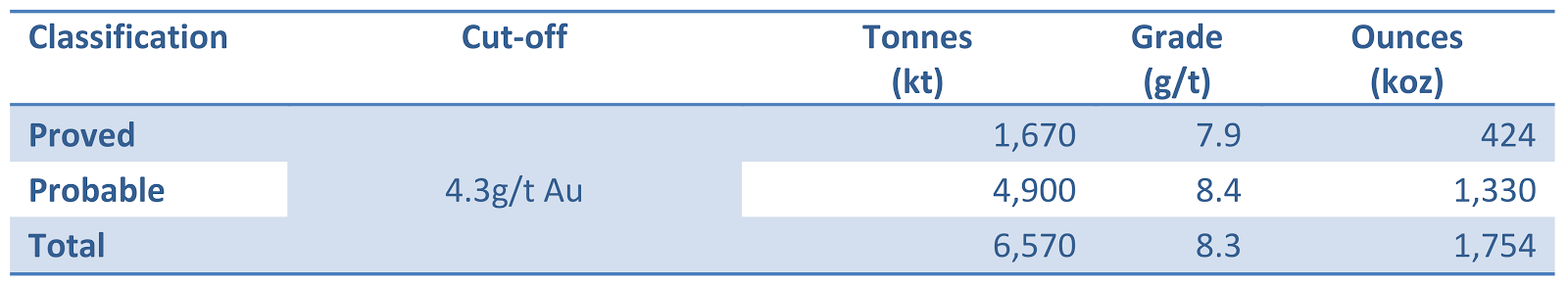

FIGURE 3 GWALIA LIFE OF MINE DESIGN BY RESERVE CLASSIFICATION.The mineral ore reserves declared for the Gwalia Deeps deposit in lines with the requirements of the 2012 Edition of the “Australasian Code for Reporting of Exploration Results, Mineral Resources and Ore Reserves”.
GWALIA ORE RESERVE SUMMARY - JUNE 2013References
