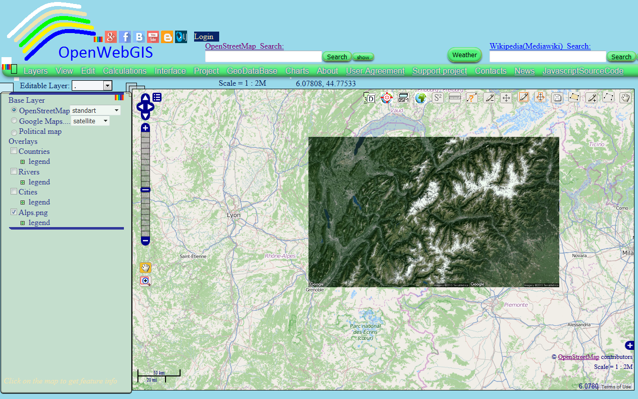

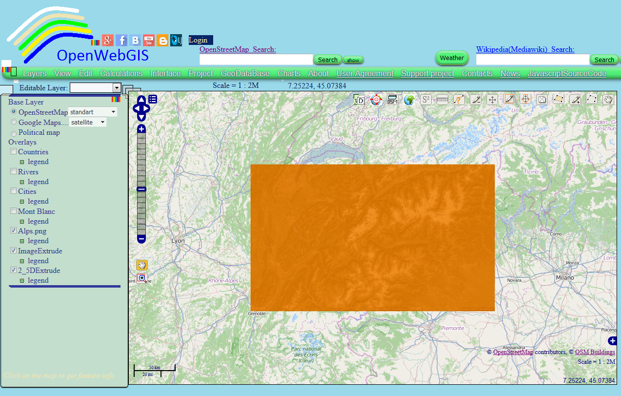

Take a satellite photo of the Alps region of Google maps. The area covered by the image is limited by the coordinates: lower left longitude: 5.6537292421837; lower left latitude: 45.20171303181052; upper right longitude: 8.400311273051333; upper right latitude: 46.35103284714349. The photo is shown in Figure 1.
Add a photo to the map by using the menu item "Layers-> New Layer from Image file". We insert the coordinates of the image corners in pop-up window, as shown in Figure 2.
The result of adding a satellite photo is shown in Figure 3
The map with the added satellite photos is available here Map 1.

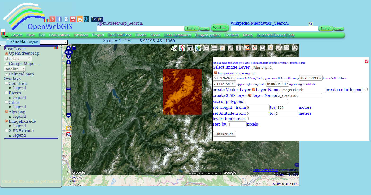

With the menu item "Edit-> Extrude Image" open the pop-up window with options for extrusion (see Figure 4) and set extrusion options such as shown in Figure 5. The height is set from zero to 4809 meters (this is the height of the highest mountain in the Alps - Mont Blanc) If you activate the option "create color legend:" you will get the vector layer with color legend (style) which fully complies with the colors of the image, but this calculation can take a long time. Let`s perform the calculation without this option for now - click "OK-extrude" button.
It is important to understand that the larger the Image in size by pixels, the longer it will take to calculate. Also an increasing the number of pixels in the options "step by: pixels" - reduces the time of calculation. The result of the calculation is shown in Figure 6. Enlarge the map and we will make sure that the vector layer consists of a set of squares (see Figure 7)

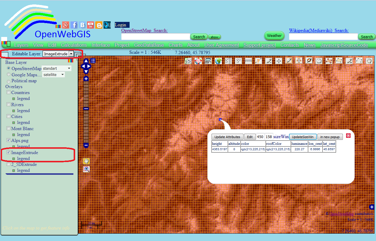

Let's see the attributes of each square. To do this, select the name of the layer "ImageExtrude" in the "Editable Layer" list. Then the values of all attributes of each square you can see by hovering the cursor over it and clicking on it (if while hovering over a point, it is not activated, then move the map a little bit and then again hover the cursor ). You need to click on the squre you are interested in, after that a pop-up window will be opened (See Figure 7).

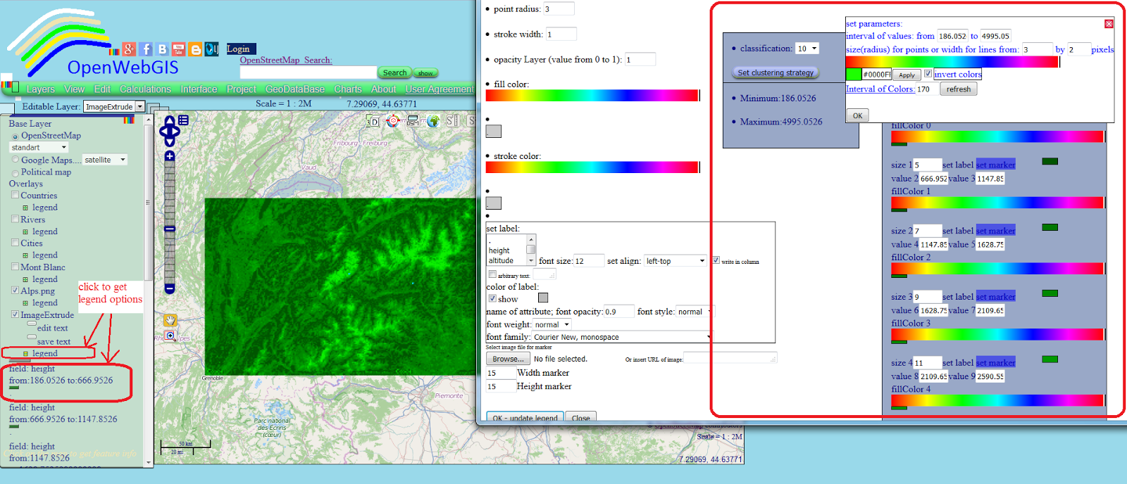

Let's change the color legend of a layer, as shown in Figure 8. In order not to specify parameters for each height value, use the button "Set automatically". Different variants of the layer style are shown in Figure 9.
The map in green style with less resolution (for fast loading) that shown in Figures 8,9 is available here: Map 2
In order to feel approximately the spatial dimension of relief (terrain), you can activate the newly created layer "2_5DExtrude". For comparison, Figure 10 shows a satellite image of an area and the same area depicted by a 2.5D columns that are based on the luminance of image pixels.
The map in green style with better resolution and with height layer with 2.5D columns can be downloaded here: download Map 3 (31 MB) . Download this file and add it to the OpenWebGIS map with the help of the menu item: "Project-> Load project file".

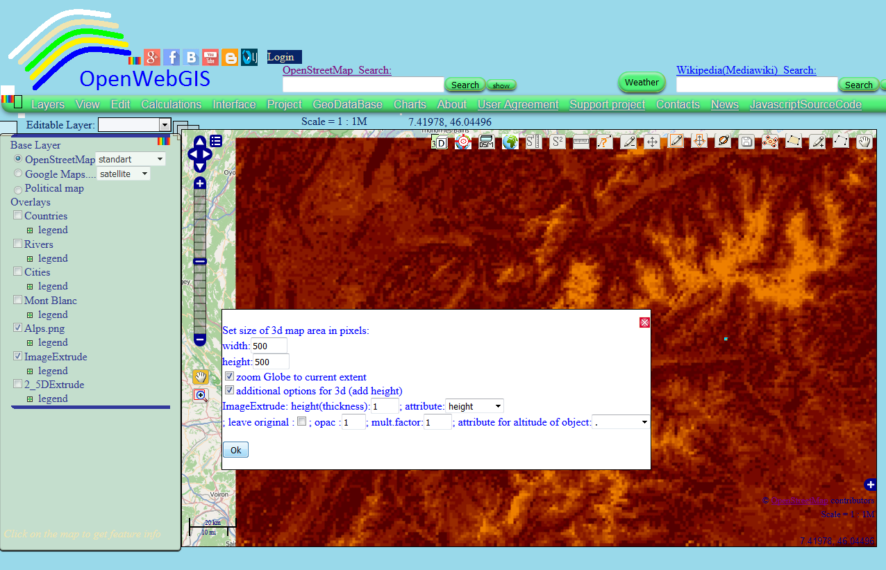

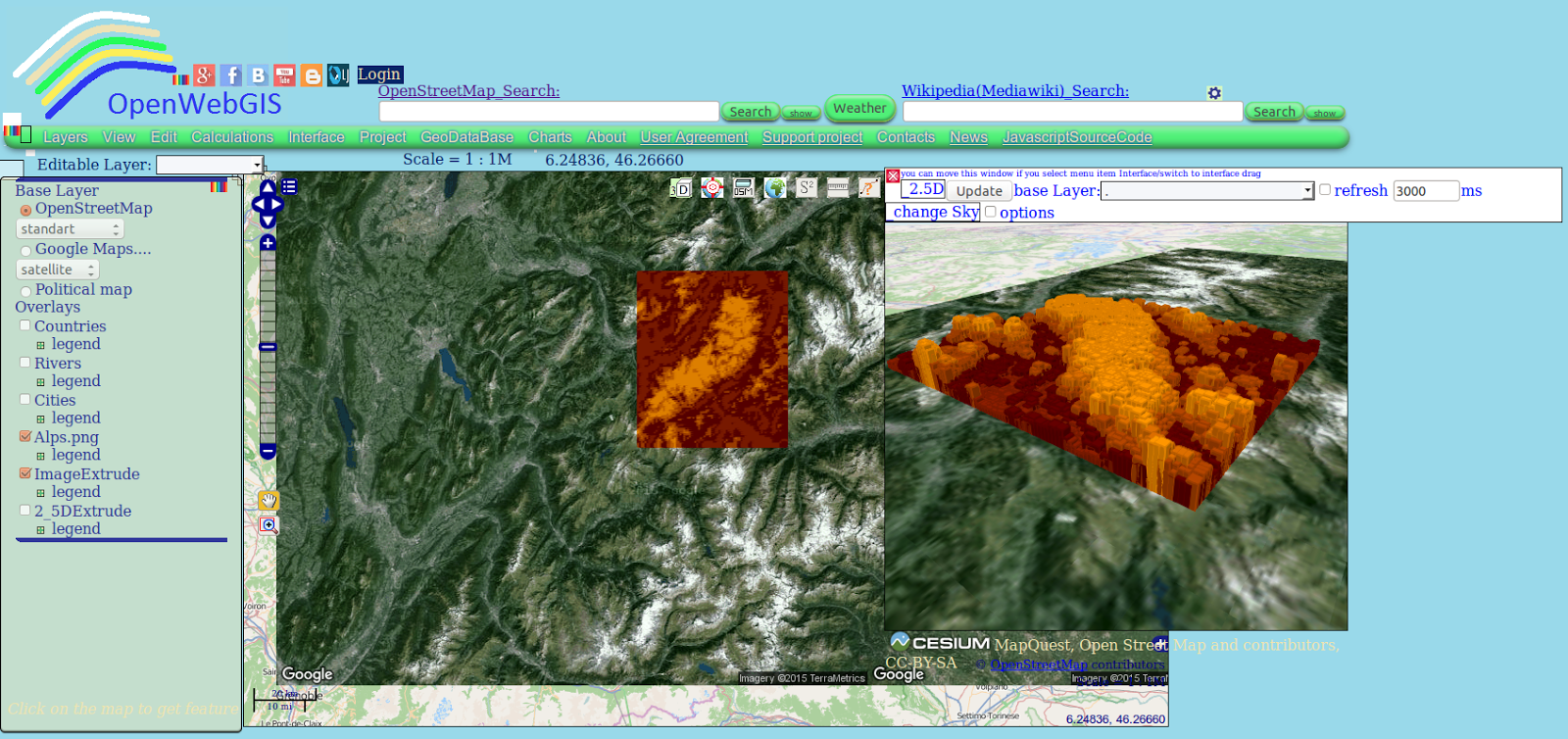

In order to create the 3D map you must click on the button:
in the upper right corner of the map. This button has the title "Add 3d Map. Globe". There will be a pop-up window in which you can set the desired size of the 3D map area in pixels. Information about 3D in OpenWebGIS is available here. Set other 3D options as shown in Figure 11 and click "Ok".
The result is shown in Figure 12.
If you try to simulate the terrain of a smaller area, there will be more details. Let's try it. Specify options in popup window "Extrude Image" such as shown in Figure 13.
The result of 3D modeling of photo`s part is shown in Figure 14.
The map shown in Figure 14 with 3D view and a height layer of 2.5D columns can be downloaded here: download Map 4 (13 MB)
