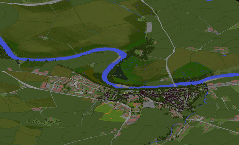

Hay-on-Wye is a book lover’s paradise. Located in the Brecon Beacons National Park in Wales, it’s also the location of a new FME-driven Minecraft project – and I must say it’s a beauty.

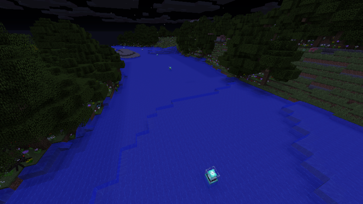

The park boundary is an important piece of information, but they didn’t want to show it as a solid line in the world. So they sampled the boundary vector, creating points every 50 meters, and styled them as beacons.
The National Park boundary is shown with beacons placed every 50 meters, here running down the center of the river Wye.

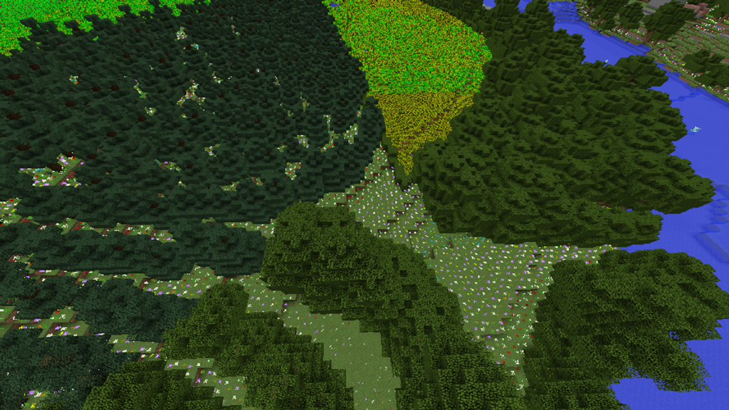

Wooded areas were mapped as polygons in the original data. And so if each point (1 meter cube) in the Minecraft output were styled as a tree, the forest would be so dense that users wouldn’t be able to walk through it.
The solution here came from advice from Safe’s in-house Minecraft expert Dmitri Bagh. By using an expression within a PointCloudExpressionEvaluator to randomize the planting of saplings, approximately 1 in 10 blocks have trees placed on them. This creates a more natural-looking distribution and leaves plenty of space to walk through the wooded areas.
An in-world view of two types of forestry and arable land.
The same expression evaluation technique is used to assign random flower types to the remaining blocks, creating varied ground cover between the trees. One note to keep in mind when planting things in Minecraft – they need something to grow from. The zero-offset blocks are assigned a grass type (dirt works as well), and then the flowers and trees are placed on it at a vertical offset of 1.

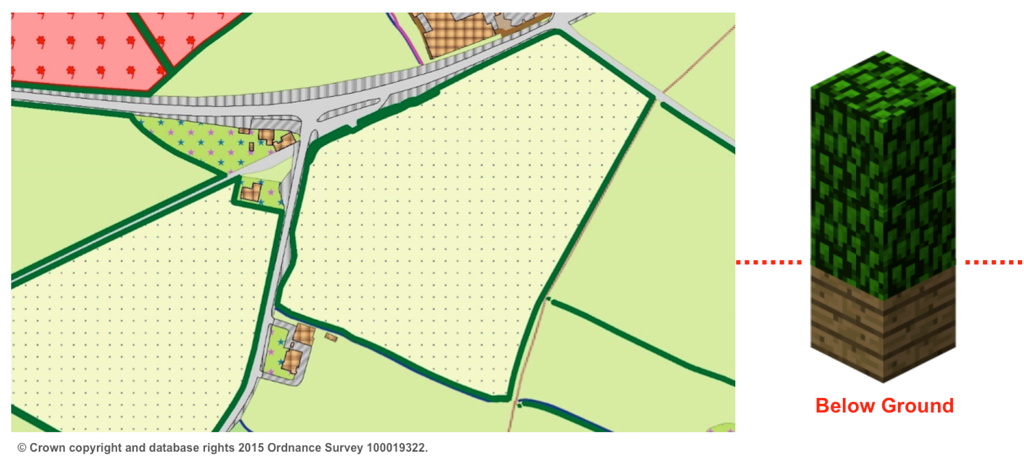

To add some aesthetic appeal and visual definition to the fields, they decided to place hedgerows around the boundaries of fields larger than 15 hectares and farmlands, leaving gaps for right-of-ways and footpaths. But Minecraft didn’t have a hedge block.
The solution here was to make one. They stacked 2 blocks of oak leaves vertically (using the offset parameter), which solved the visual part of the problem. But oak leaves will decay if they aren’t within five blocks of wood – and so they sunk a wooden block under the ground, with an offset of -1, to keep the hedge green and alive.
Two blocks of oak leaves placed on a buried wood block creates hedgerows that will stay green and alive.
