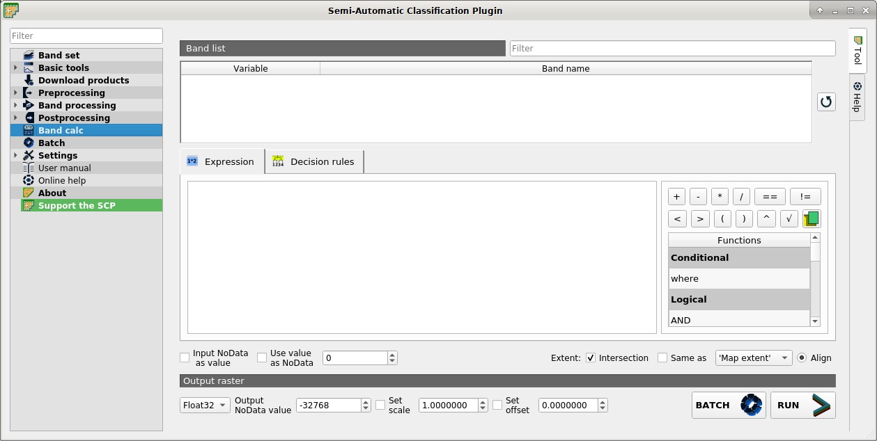

With the new Band calc tool it will be possible to perform raster calculations with multiple parallel processes (based on system availability) where each thread performs a part of the calculation and the result is computed very rapidly (if compared to single thread).
Interface
The interface has been revamped to allow for additional settings regarding NoData values and raster data type selection (Float32 (default), Int32, Int16, UInt32, UInt16, Byte), therefore a smaller output size can be achieved.
