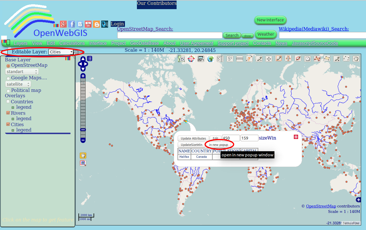

In order to add the images, videos, texts, websites to the page you need to create a popup window where all this will be placed. To do this, it is necessary to select any Layer's name in the dropdown list "Editable Layer". Let's suppose, for example, it will be a layer of "Cities". Then click (on the map) on the point (city) you are interested in. The values of all attributes of each point you can see by hovering the cursor over it and clicking on it (if while hovering over a point or polygon, line, it is not activated, then move the map a little bit and then again hover the cursor).
You need to click on the feature you are interested in, after that a pop-up window will be opened (See Figure 1).

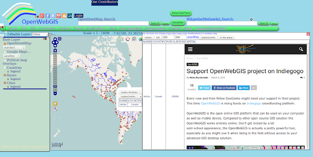

In this window click on the button "in new popup". The new independent (separate) popup window (See Figure 2) will appear on your page.

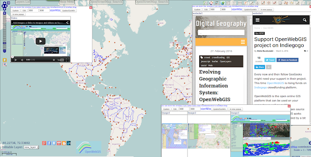

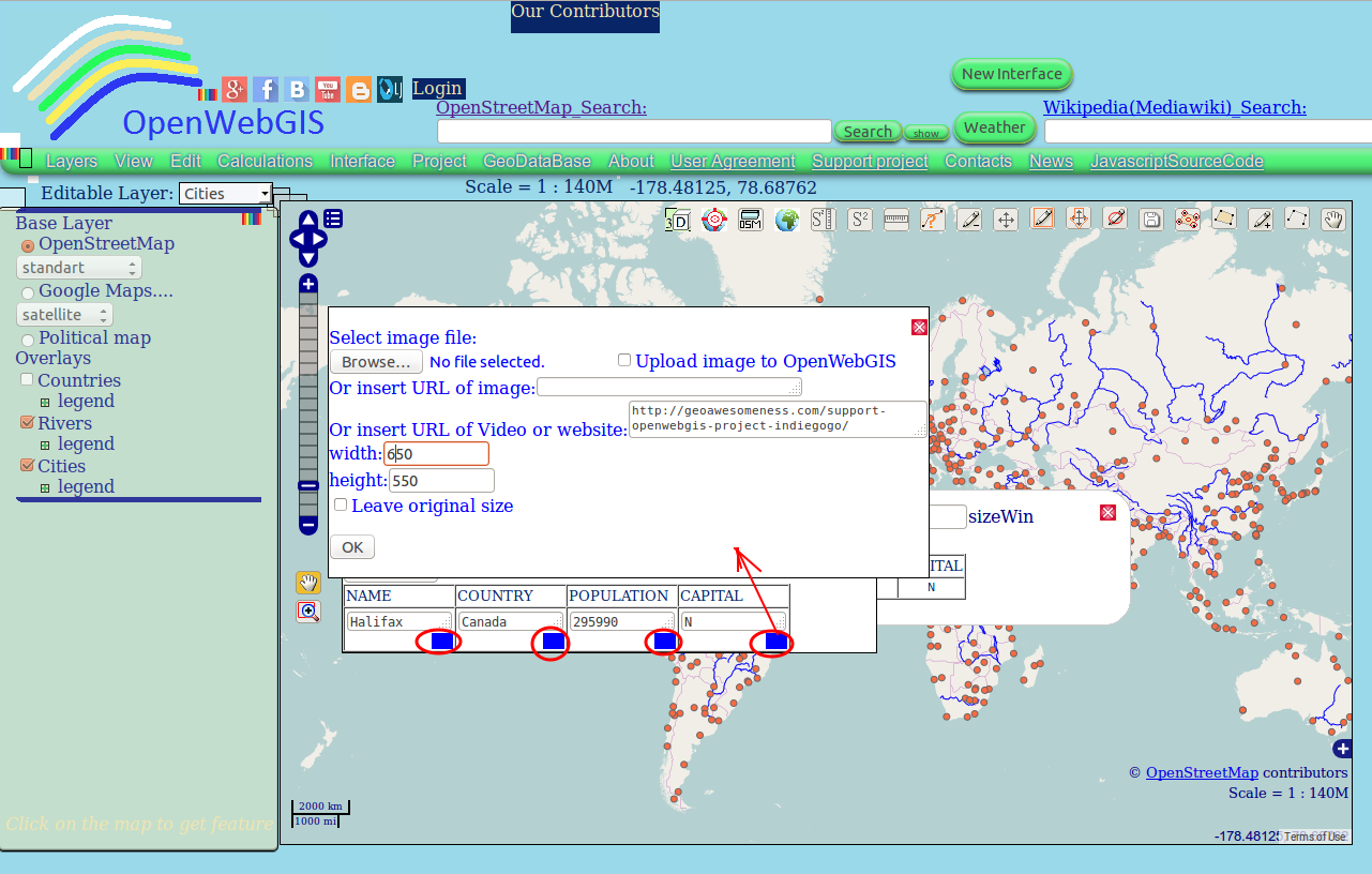

After pressing "Edit" under each attribute (cell) there will be a blue square (see Figure 3), you must click on it to get the window where you can set options to add an image, video or website as an attribute.

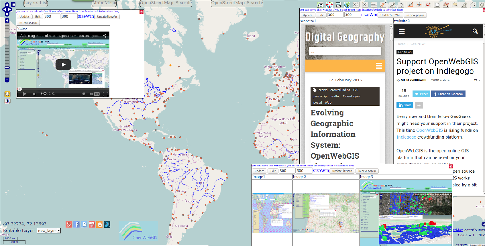

Let's add a website and set the width and height of the cell where it will be opened as it is shown in Figure 4.

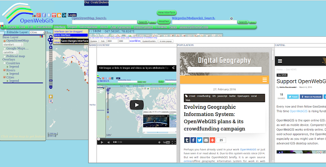

Click the "OK" button and get the result shown in Figure 5. Click on the button "Update" in the window shown in Figure 5, and the inserted websites and video will look as it is shown in Figure 6.
You can move this window (with websites, images and videos) if you select menu item "Interface->switch to interface drag". After that you can save your interface in your browser local storage - select the menu item "Interface->Save interface". In this case, every time you open OpenWebGIS site it will be loaded into the interface that you saved (including the added sites, videos, and images).

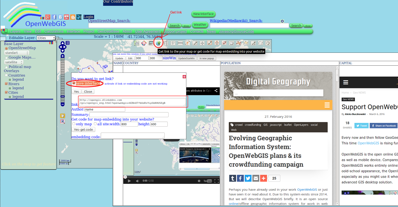

In order to keep your workspace on the OpenWebGIS server and receive web-link to it, click on the button "Get link" in the upper right corner of the map and in the open options window, activate the option "save interface" and click "Yes" (See Figure 7).
Copy the link received from the field "link". The example of saved interface is available at this link.

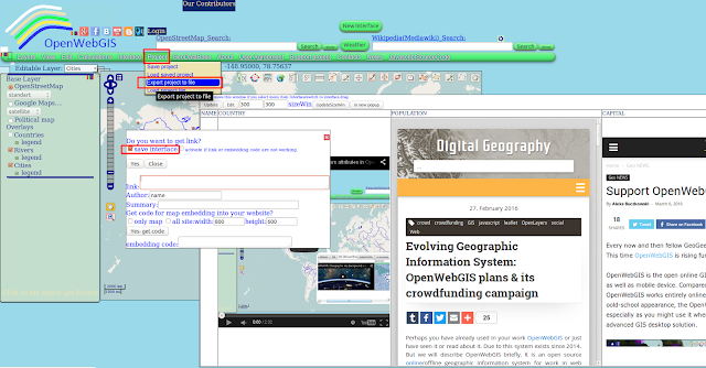

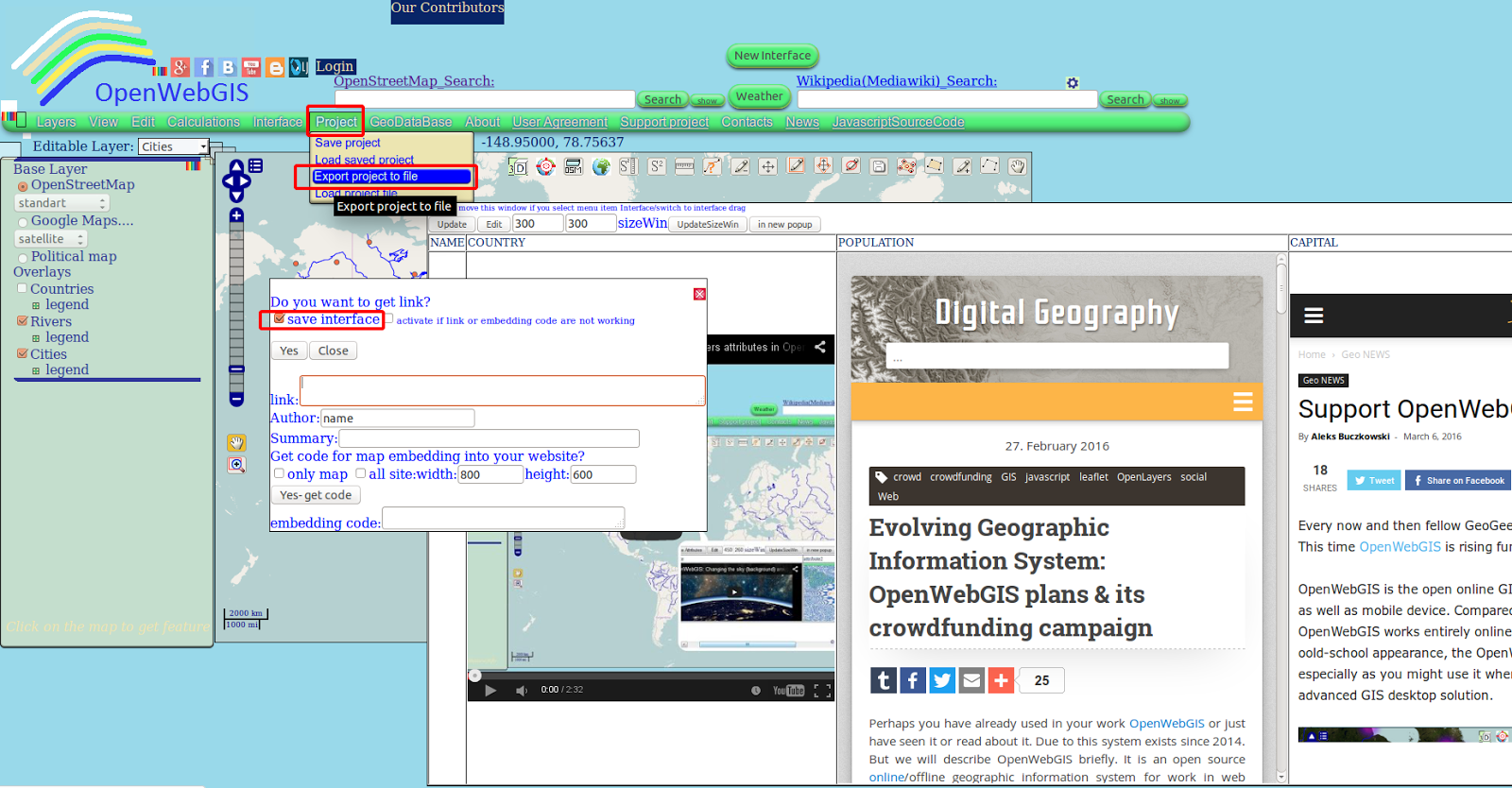

In order to save the map and the interface in the text file you need to partially repeat the above steps, that is: click on the button "Get link" in the upper right corner of the map, activate the option "save interface", and then select "Project->Export project to file" menu item (See Figure 8).
Then a window will open with the contents of a text file, to save it on your disk, click "Save Data" (See Figure 9).
