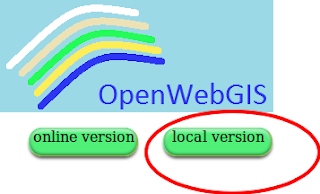

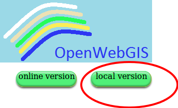

In order to collect parameters of WiFi points with the help of OpenWebGIS first turn on geolocation of your mobile device. Then you need to run on your device OpenWebGIS version for Android, after that select in the first window - the local version (see Figure 1).
Figure 1 - Run on your device OpenWebGIS version for Android, after that select in the first window - local version

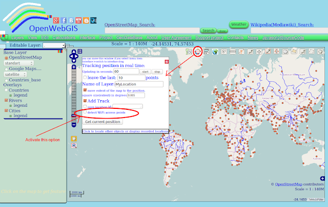

After running Android version of OpenWebGIS click on the button at the top right corner of the map (see Figure 2), then a window will appear with geolocation settings. In this window the new option was added called «detected WiFi access points». Activate this option to collect information about WiFi access points.

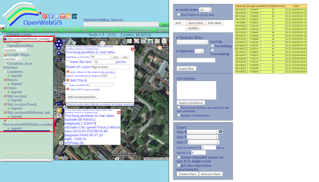

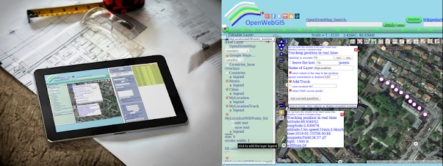

Figure 2 - Activate «detected WiFi access points» option to collect information about WiFi access pointsSet the desired time «Updating in seconds» and click on «start» button. After that, four new layers will be added to the list of layers. These new layers will contain information on the points, track of your movements, WiFi access ponts list and number of WiFi access points respectively. The additional popup window will also appear, which will show and update geolocation information and sensor data and number of WiFi points (see Figure 3), other sensors outputs and information about WiFi will be added to the attributes of the respective layer (see Figure 4). In these figures the information is given as an example but is not real.
Figure 3 - The additional popup window shows and updates geolocation information, sensor data and number of WiFi access points Figure 4 -All data recorded at each point is added to the attributesp { margin-bottom: 0.25cm; line-height: 120%; }a:link { }

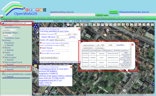

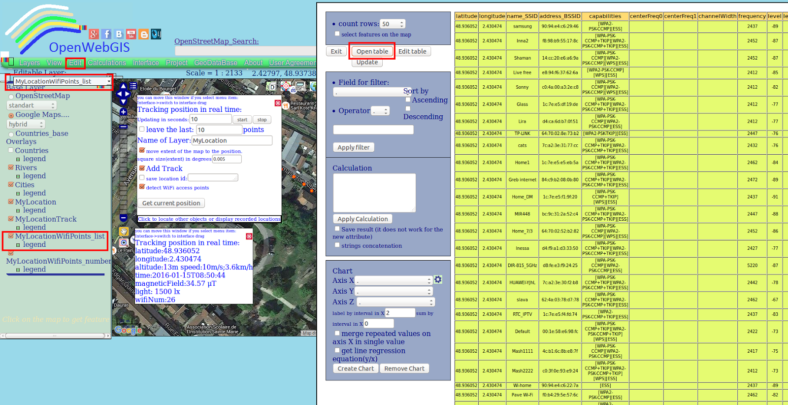

You can see all data recorded at each point, if you select Layer's name ("MyLocationWifiPoints_list" or "MyLocationWifiPoints_number" - in our case) in the dropdown list "Editable Layer". Then click (on the map) on the point you are interested in. The values of all attributes of the point you can see by hovering the "cursor" over it and clicking on it (if while hovering over a feature, it is not activated, then move the map a little bit and then again hover the "cursor"). After clicking on the feature you are interested in, the pop-up window will be opened. In this window you will see all layer attributes (see Figure 4).

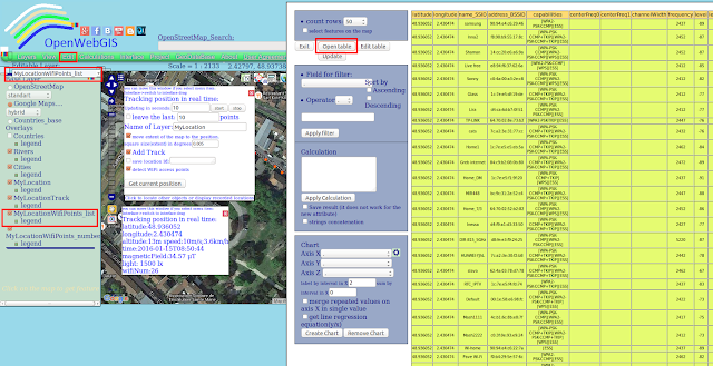

There is another way to see all data: if you open the attribute table using the menu item "Edit-> Open attribute table" (see Figure 5).
Figure 5 - Open the attribute table using the menu item "Edit-> Open attribute table"
List of all attributes of "MyLocationWifiPoints_list" Layer is presented in the table below:

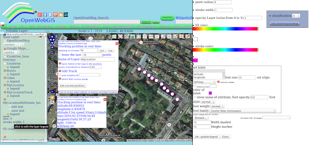

Figure 6 - Attributes of "MyLocationWifiPoints_number" LayerExample of changing Layer legend is shown in the Figure 7.
Figure 7 - Example of changing Layer legend
