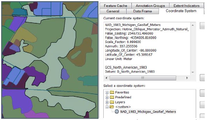

1. Prepare your features in which sampling will occur. This should be a polygon feature class (e.g., soils, vegetation, or ownership polygons). It will be simplest if the features in which you wish to sample are in their own layer. Add the polygon layer to a new map document and verify that the coordinate system / map projection for the data frame is set correctly.
Figure 1: parcel to sample (tan) and data frame coordinate system properties

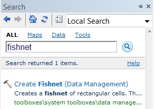

2. Open the Create Fishnet (Data Management) tool. You may use the search window (Ctl-F or Window > Search and enter fishnet) or open ArcToolbox and expand Data Management Tools > Feature Class > Create Fishnet.
Figure 2: Create Fishnet tool in the search window

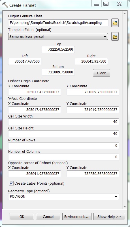

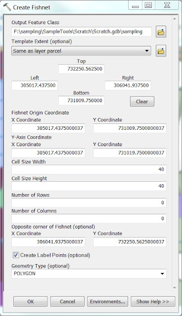

3. Set the output feature class (shapefile or geodatabase feature class) and set the Template Extent to Same as layer , i.e., if your layer in step 1 was a feature class named “parcel”, you would set the Template Extent to Same as layer parcel.
4. Enter the desired point spacing in Cell Size Width and Cell Size Height. These values should be in the units your layer’s projection uses (probably meters). 20 meters is about a chain, so to use 2-chain spacing you would enter 40 for both the Cell Size Width and Cell Size Height values. If using set a cell size, enter 0 for both the number of rows and columns (these will be determined automatically).
You can also choose the number of rows and columns desired and the point spacing will be set automatically, though for most sampling it’s simpler to adjust the distance.

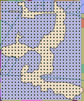

5. Ensure Create Label Points (optional) is checked and set the Geometry Type (optional) to Polygon. Click OK to generate the lattice point labels and polygons.
Figure 3: Create Fishnet tool options and output results (polygons and points)

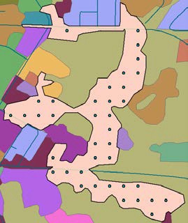

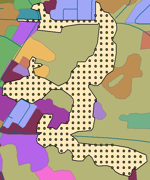

6. The new layers will be added to your map. Turn off the polygon layer and open the Clip (Analysis) tool (use the Search window or open ArcToolbox and expand Analysis Tools > Extract > Clip). Set your lattice points (labels) as Input Features and the layer you are sampling in (from step 1) as the Clip Features. Choose an Output Features layer and click OK to clip your points. This step is necessary because a lattice is always square (or rectangular) and unless the area you are sampling in is also square or rectangular, the lattice extent will be partially outside its polygons.
Figure 4: Clip results. Note many sampling locations appear near or on the parcel border.

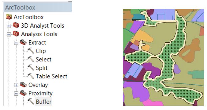

7. Optional step: if you wish to keep your sampling points a set distance away from the boundaries of your parcel, use the Buffer tool (Analysis Tools > Proximity > Buffer) and generate an “inside buffer” in your sampling area. Your area to be sampled will be the Input Features, choose a new shapefile or feature class as the Output Features, and use a negative value as the buffer Distance value. A value of -20 meters would keep the sample points a chain away from the parcel boundaries. Use the output from this step as the Clip Features in step 6.
Figure 5: Buffer tool in the ArcToolbox window and clip results using a 20 meter inside buffer (green). Note no sampling points are within a chain of the parcel’s border.
8. Generating sampling points is an iterative process. You will likely need to repeat the steps above to increase (or decrease) the point spacing. Adjustments will differ depending on the acreage you are sampling, the shape of the parcel(s), and any buffers you may use to avoid the edges of the parcel. The 40 meter (2 chain) spacing used in the example above produced 138 sampling locations in a 36 Ha (88 acre) area, about four times what is suggested by the “16 points per 40” rule of thumb for overstory sampling. An 80-meter spacing (about 4 chains) yielded 38 sampling points, as shown below.
Figure 6: Results of 80-meter point spacing grid.
