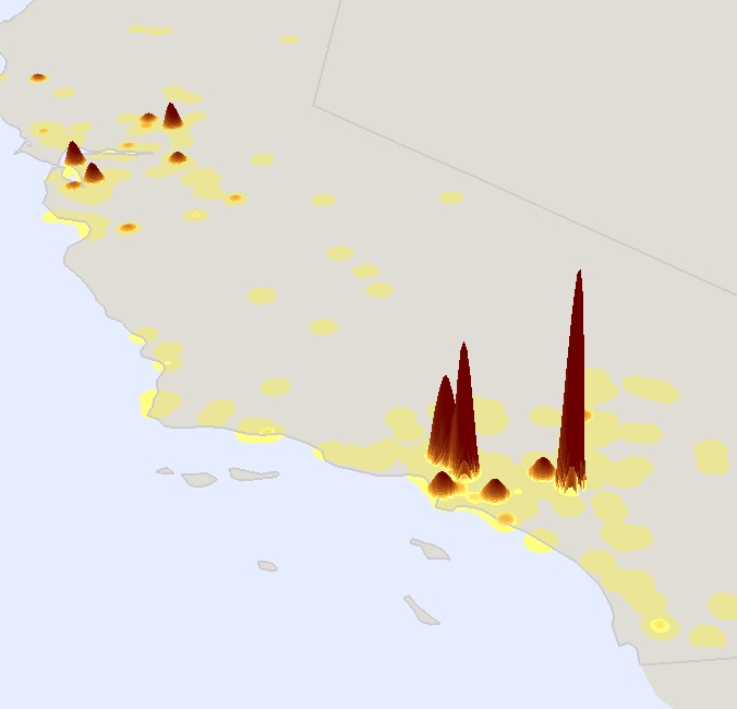

The function of a standard heat map can be extended by treating the new surface as an elevation surface and extruding the density values in 3d. The resulting maps show off data spikes and dips as a terrain-like representation of values.

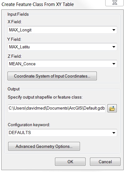

[h=3]Create a Z enabled point layer[/h]In order to create a density surface that can later be viewed in 3d we need to add a Z attribute to our imported table data. If starting with an existing point layer you will need to export the attribute table (with XY coordinates) and re import with Z values.
 In ArcScene, open a new connection in the catalog side bar
to your data table.
 Right click on the table and choose Create Feature Class
From XY Table.
 Project your new point layer to match the project
coordinate system.

[h=3]Create Elevation Surface[/h]Because most data ranges are underwhelming when displayed in 3d using their normal Z values, we need to create an alternate factored elevation surface to create the steep peaks and valleys we want for this visualization. You may need to experiment with various Z factors to get the right look.
 Open the Raster Calculator tool
 Add the density surface from above and multiply by the required factor
 You can un check the new layer visibility in the table of contents

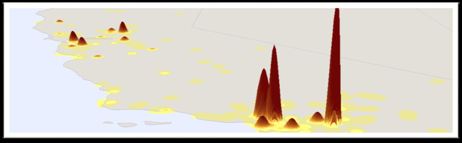

 Open the original Density layer properties and choose the Base Heights tab
 Set Elevation from surfaces to Floating on a custom surface and choose the new elevation layer as the surface to extrude the Density surface by the re calculated Z values in the Elevation surface
 You can improve the appearance of clustered data spikes by turning on the Hillshade effect under the layers Symbology tab.
