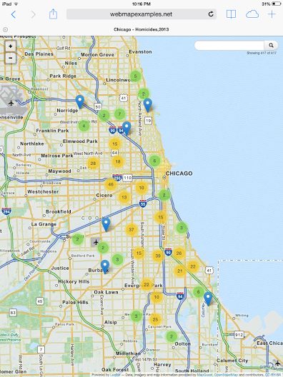

If you want to skip to see the end result, click this link: http://webmapexamples.net/leaflet-simple-csv-master/index.html. The screenshot below shows the map on an iPad Mini (Gen 1). Click for a closer vew.
On iPad Mini: A Leaflet Map of Homicides in Chicago, 2013How I got there...

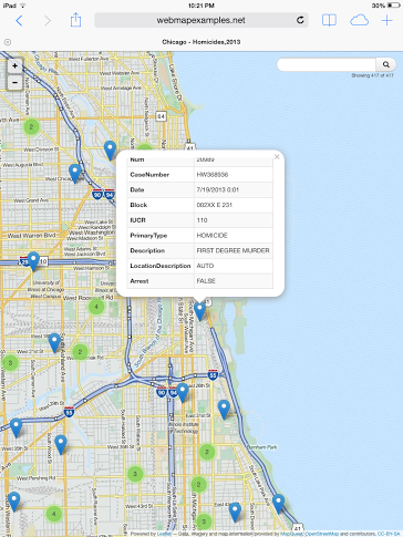

There are several Leaflet plugins to import *.csv files. On the web, I found the Leaflet Simple CSV Plugin by Matthew Perry that incorporates several different plugins, including a bonus one for clustering/collecting markers, into one set of code. Furthermore, it contains code for allowing attribute data from the *.csv file to be displayed when a marker is clicked.
Pop-up displaying attribute data from the *.csv about the homicideThe code package put together many different capabilities. It was easy-to-use, modify, has documentation, and a working example. I accessed the maps on several devices: two different computers, the iPad mini, an iPhone 4S, and a Nexus 7 tablet. The only device that had an issue was the iPhone 4S. When clicking a point market, pop-up attribute data was not always displayed and simply flickered. I am still looking into this and will post anything I found out.
