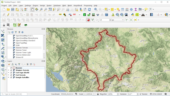

This script should be run from the Python consol inside QGIS.
It adds online sources to the QGIS Browser.
Each source should contain a list with the folowing items (string type):
[sourcetype, title, authconfig, password, referer, url, username, zmax, zmin]
You can add or remove sources from the sources section of the code.
Script by Klas Karlsson
Sources from https://qms.nextgis.com/
Licence GPL-3
Regarding the terms of use for these background maps YOU will need to verify that you
follow the individual EULA that comes with the different services,
Most likely they will restrict how you can use the data.

# Add sources to browser
for source in sources:
connectionType = source[0]
connectionName = source[1]
QSettings().setValue("qgis/%s/%s/authcfg" % (connectionType, connectionName), source[2])
QSettings().setValue("qgis/%s/%s/password" % (connectionType, connectionName), source[3])
QSettings().setValue("qgis/%s/%s/referer" % (connectionType, connectionName), source[4])
QSettings().setValue("qgis/%s/%s/url" % (connectionType, connectionName), source[5])
QSettings().setValue("qgis/%s/%s/username" % (connectionType, connectionName), source[6])
QSettings().setValue("qgis/%s/%s/zmax" % (connectionType, connectionName), source[7])
QSettings().setValue("qgis/%s/%s/zmin" % (connectionType, connectionName), source[8])
# Update GUI
iface.reloadConnections()
