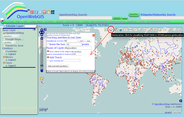

Figure 1 - Run on your device OpenWebGIS version for Android, after that select in the first window - local versionThen click on the button at the top right corner of the map (see Figure 2), then a window will appear with the settings geolocation.

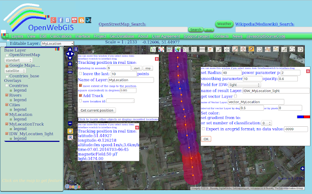

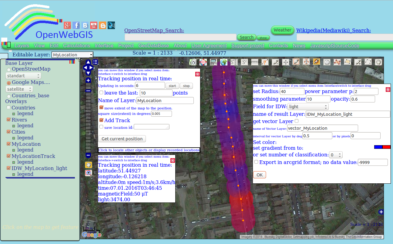

Figure 2 - Click on the button at the top right corner of the map to get geolocation settingsp { margin-bottom: 0.25cm; line-height: 120%; }a:link { } Set the desired time «Updating in seconds» and click on «start» button. After that, new layers will be added to the list of layers. Points and a track of your movements will be added to these new layers. The additional popup window will also appear, which will show and update geolocation information and sensor data - light (illumination), magnetic field and temperature (see Figure 3), and other sensors outputs will be added to the attributes of the respective layer (see Figure 4). In these figures the sensors data is given as an example but is not real.
Figure 3 - The additional popup window shows and updates geolocation information and sensor data
Figure 4 -All data recorded at each point is added to the attributes

Figure 7 - Result of interpolation of collected illumination data At the moment in OpenWebGIS you can automatically collect data of the following sensors: accelerometer, gyroscope, light, temperature, magnetic field, pressure, rotation vector. The presence or absence of any of these sensors is determined by OpenWebGIS automatically.
