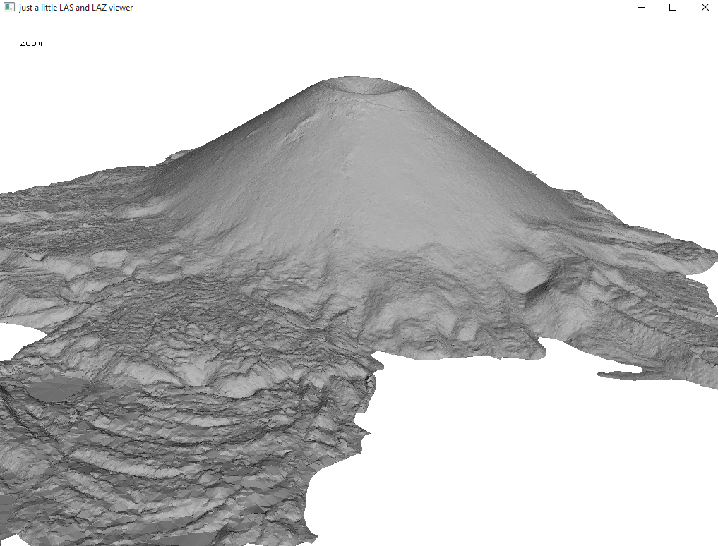

Tip #5: When using lasview in QGIS, pressing Space bar changes your ability to navigate from zoom, tilt,pan, and translate. In the upper-left of the window, you will see the navigation type change as you press it.
Furthermore, right-clicking the mouse, brings up a menu for changing the view of LIDAR, from selecting returns, how to symbolize/color data.
The right click menu in LAStools
Tip #6: To get a 3D view, press Space bar until Pan is displayed, if is not already. Click and hold your mouse, then move it up to the top of the screen and voila!
Wizard Island, Crater Lake, Oregon, Data from: Open Topography. lasnoise was also used.See also:
