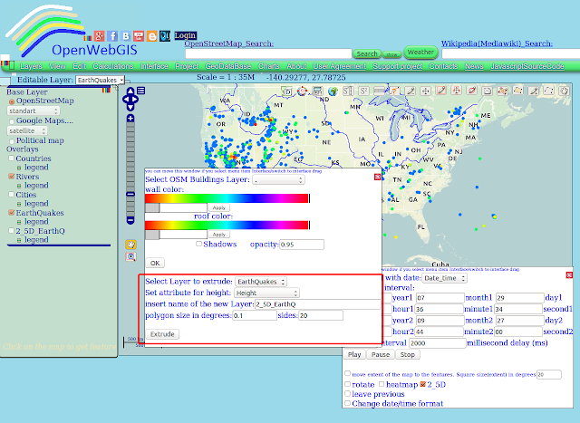

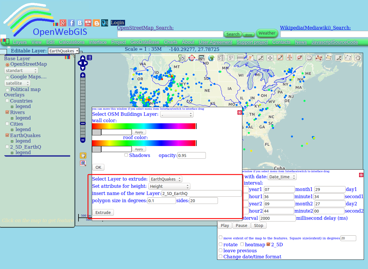

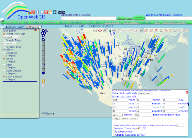

Figure 2p { margin-bottom: 0.25cm; line-height: 120%; }a:link { }Then select menu item"View-> Time Line" and activate the option 2.5D (See Figure 3), then there will be a settings window of 2.5D columns. Set the options as shown in Figure 4. Press "Extrude" button and result will be like shown in the Figure 5.

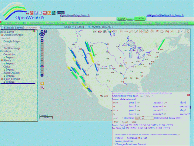

Figure 5Click button "Play". And you will see what is shown in Figure 6 and in the video below.
