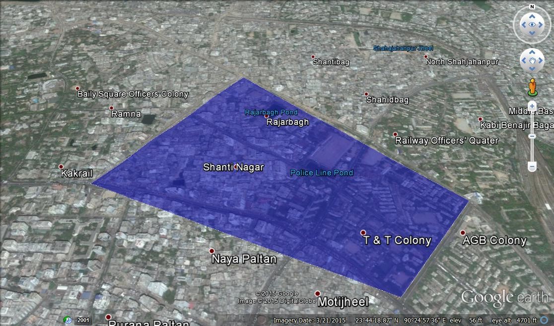

Flood prevention through rainwater harvesting is a smart choice as it’s cost- effective and can capture sufficient amount of water. Rainwater harvesting design consist of Roof (catchment area), gutter roof washer, filter and cistern. Dhaka’s annual average rainfall is approx 73.1 inches and almost 80% occurs during the monsoon season. For this project I selected highly built-up area ( mostly high rises) of Shantinagar and some part of Motijheel in Google Earth and calculated the area. The total study area cames to 221.00 acres or 9,626,760 ft2. As majority of the study area is consist of high-rise buildings. I assumed that surface and rooftops area as same in ft2.
It looks from the image that the streets and space between buildings may take up to 10% of total area that wouldn't be available for rain harvesting. I subtracted 10 % of the surface area ( catchment area) for this study. The reduced catchment area equals to 86,740,840 ft2.
