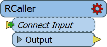

For advanced statistics, we now have the RCaller transformer. This means you can run any R script in the middle of your FME workflow. Integrate any of FME’s supported formats, use R to get advanced stats, tests, and analyses, apply transformations to the data based on the results, and then write the output to any of FME’s supported formats.

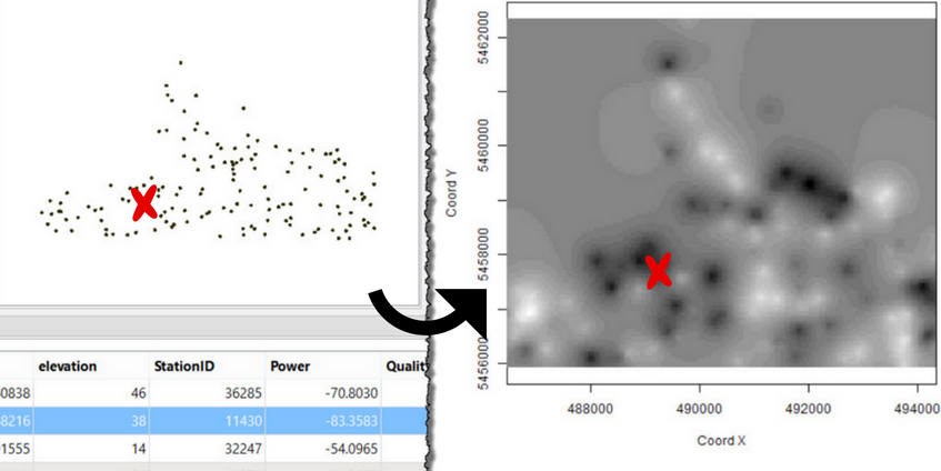

Aye, we’ll be usin’ rigging ter create a map ter buried treasure— oh wait, no. Kriging. We’re using Kriging, an interpolation method, to create a raster surface model from point data. But it’s still a map ter buried treasure, yarrr!
Using R to generate a pirate map raster from CSV point data.
After reading the source points, the FME workflow passes the X and Y coordinates to the RCaller. The RCaller runs an R script to interpolate points into a raster and create a temporary .png file. This temporary raster is then read back into the workflow and can be used for further processing.

R is under the GPL license, which means we can’t ship it with FME, so you have to install it manually. But once it’s installed you can use it in FME simply by adding an RCaller to your workspace. - Use data frames to reference the data you want to use in the R script.
- Your script must have an ‘fmeOutput’ value if you want to send it back to FME for further processing.
Using R to generate a pirate map raster from CSV point data.After reading the source points, the FME workflow passes the X and Y coordinates to the RCaller. The RCaller runs an R script to interpolate points into a raster and create a temporary .png file. This temporary raster is then read back into the workflow and can be used for further processing.
- Try it: See the steps and download the workspace on the FME Knowledge Center.
