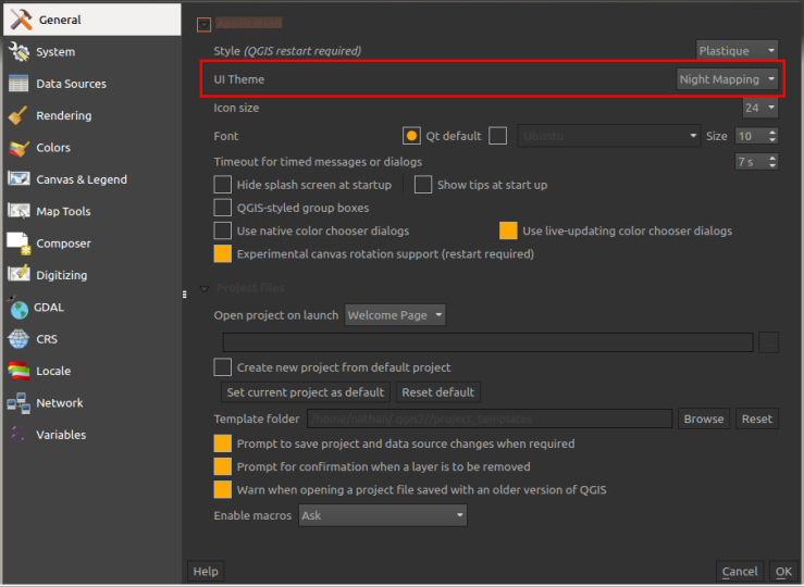

You can now change the color scheme of QGIS to suit your liking, daytime, or nighttime mapping lifestyle. I am sure that the QGIS Community will come up with some neat themes--and at least one in QGIS green! Note: As of writing, there has been a bug that will be quickly fixed. How to make changes are described by the feature's creator here: http://nathanw.net/2015/08/29/ui-theme-support-now-core-in-qgis/. The default UI can be rather bright being both gray and white. Having some contrast can definitely help users in certain settings.
You can now change the UI theme to suit your liking.
Image source: http://nathanw.net/2015/08/29/ui-theme-support-now-core-in-qgis/

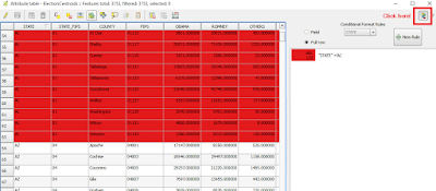

Cells in attribute tables can now be color coded based on rules. This can help to identify certain groups of data as well help to highlight errors or outliers. It is easy to overlook the new button for this feature. After opening the attribute table, look in the upper right-hand corner for a small button with color bars stacked. Click the image below to get a closer look at its placement.
In the table above, records for Alabama ("STATE"='AL') are highlighted in Red,
while Arizona's records below are not highlighted.The color formats are saved, so when you re-open your QGIS project and the attribute table they will still be there. It is a good way to keep notes or tag certain records for later.
