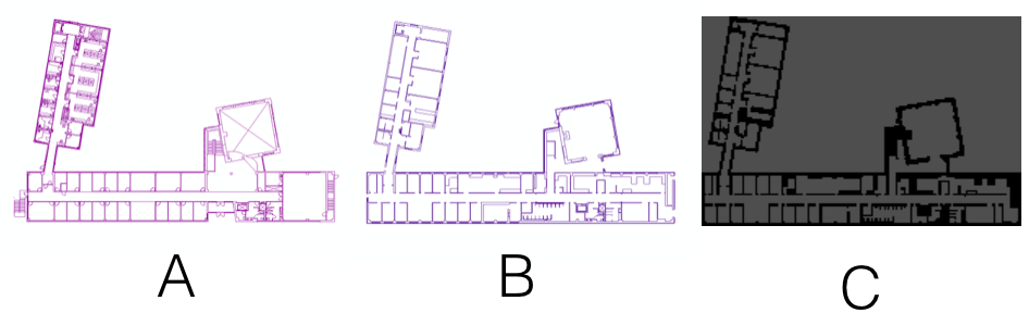

In the second model (shown in the movie below and the code is here) we show a more complicated configuration based on a floor plan that has been first converted from a CAD file to a Shapefile before being converted into a raster where each cell is 50cm by 50cm that can then be used in the NetLogo model (coming soon there will be a bunch of tutorials on how we do this).
From CAD File (A) to Shapefile (B) to Raster (C)
In this model, agents like in the simple model above, walk to the exit. In essence, one could consider this as a fire evacuation scenario. The agents are assumed to walk to the nearest exit, analogous to following exit signage. Similar to the first example, user can explore what happens if an additional exit is added.
From CAD File (A) to Shapefile (B) to Raster (C)In this model, agents like in the simple model above, walk to the exit. In essence, one could consider this as a fire evacuation scenario. The agents are assumed to walk to the nearest exit, analogous to following exit signage. Similar to the first example, user can explore what happens if an additional exit is added.
