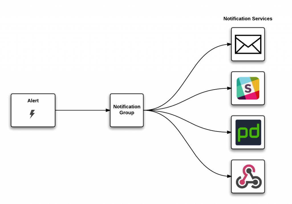

FME Cloud Monitoring is comprised of three components: Alerts, Notification Groups and Notification Services. You can read the full doc here, but here is an overview.
- Notification services define the communication protocols for delivering alerts. FME Cloud supports email, PagerDuty, Slack, and Webhooks.
- A notification group is the collection of notification services assigned to an alert.
- An alert defines the instance conditions you want to be notified about.

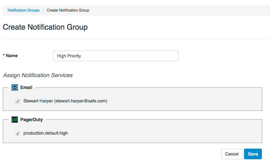

Create Notification Group
Now that you have defined the endpoints you wish to deliver the alerts to, you need to create a notification group. We’ll create a group called High Priority and assign the email and PagerDuty services that we just configured to it. I can now assign this notification group to as many alerts as I want. In a simple setup you might only have a few notification groups, e.g. low and high priority. But as you tailor things and add further instances (e.g. staging, production and development) the notification groups become very useful.

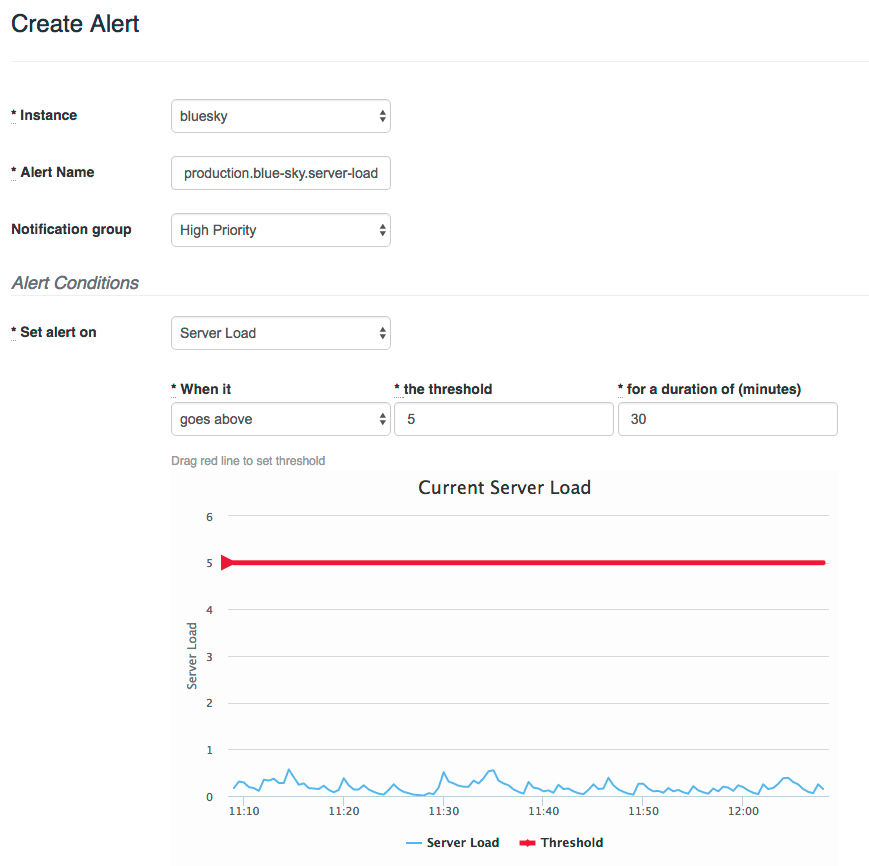

Configuring the Alert
The alert is the final piece and this is where we define the instance condition that we wish to be notified about. So in our case we are going to trigger an alert if the server load goes above 5 for 30 minutes. If that happens a message will be sent to all services in the High Priority notification group.

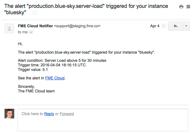

If an alert triggers a message will be sent to PagerDuty and email.
When an alert clears, an email will be sent to alert the user and in PagerDuty the incident is auto-resolved.
