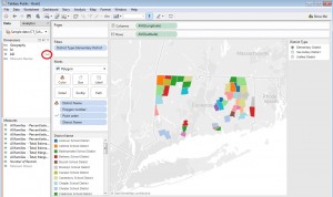

- Because the Sample data sheet has an*Id2*column, Tableau should*be ready to join the Sample data with the*Polygon sheet by the common Id2 field. Click the chain icon, circled*in the Dimension pane below, to set up this relationship:

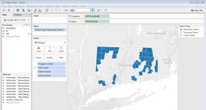

- In the map above, District Name*is on Color on the Marks card. We’ll want to create a choropleth map based on one of the measures in the Sample data data source, but we will still need to keep the School District dimension*in the visualization, letting Tableau that School District is the unit of analysis or “level of detail”. Move*District Name*from Color onto Detail on the Marks card. You should now see the districts are*the same color, but still outlined:
- Now drag any measure you want to show on the map, e.g. ‘All families- percent below poverty level; Estimate; With children under 18‘ onto Color on the Marks card to create a filled map.

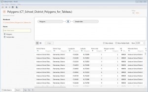

- Drag down on the Data menu, and from the carrot menu for the Polygons (CT_School_District_Polygons_for_Tableau) data source select Edit Data Source. Drag the Sample data sheet into the data workspace:
- Normally you will want to join the Polygon sheet with your data sheet using a Left join. Click on the venn diagram in the data workspace to bring up the Join dialog box. Click on the image illustrating Left join. The Polygon Data Source sheet should be joined to the Sample data sheet with the join clause Id2 = Id2 (Sample data):
- Follow steps 4 & 5 above to create the filled map.

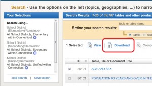

- The U.S. Census Bureau’s American FactFinder*data portal provides close to 15,000 data tables for Connecticut school districts from various Census Bureau programs, including the 2000 and 2010 Decennial Census, the American Community Survey, and the Annual Survey of School System Finances. Use this bookmarked table*as a starting point. Above the Age and Sex table, click the Advanced Search button (circled below). This will take you to the main American FactFinder search page, and all Connecticut school districts are pre-selected in the Your Selections window.
Use*the*Topics menu to browse a subject index of population, demographic, and economic tables at the school district level. To download tables you’ve located, from the Table, File, or Document Title results window, put a check next to the table ID to select any table or tables, and use the Download icon above the list to download the table(s) for all selected geographies in a .csv format that Tableau will be happy with. Use the Id2 field in datasets downloaded from American FactFinder to join the data with the Polygons sheet, as we did with the Sample data sheet above.
