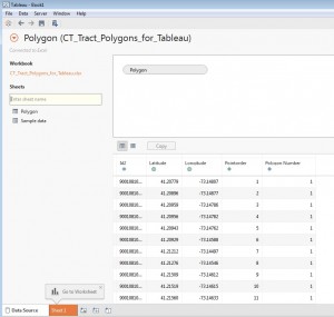

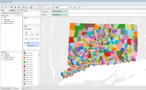

- Save a copy of the Excel workbook of Connecticut Census tract polygons locally. In Tableau Public or Desktop, from the Data menu navigate to the workbook and drag the Polygon*sheet into the data space. Click Go to Worksheet or open a new New Sheet on the task bar.
- Under Measures in the Data pane, drag Longitude to the Columns shelf. Note that the Aggregation for this pill should be average; i.e. the pill should say AVG(Longitude). Aggregations can be changed if necessary (e.g. from Sum to Average) from the carrot menu for the measure in the rows or columns shelf.
- Drag Latitude to the Rows shelf. The aggregation should also be average (AVG) in the pill.

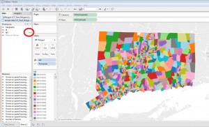

- In the Marks card, change the view type menu from Automatic to Polygon
- If Pointorder appears in the Measures pane, it must be converted to a Dimension – simply drag it from Measures to Dimensions. Then, drag Pointorder to Path on the Marks card. (Don’t panic, it is normal to see a strange Rorschach test-like image on the map at this stage!)
- Drag Id2*from Dimensions and place it on Color on the Marks card. The Id2 field contains the unique 10-digit Census identification number for each tract, and will be used below to join American Community Survey data with the map.
You should now see the outlines of all 833 Census Tracts (click the image above to see the full view) and you can now* link or join this base map to other data following steps in either Option 1 or Option 2 below.

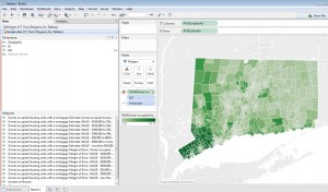

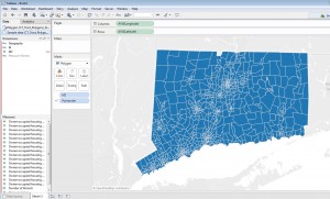

- In the map above, Id2*is on Color on the Marks card. We’ll want to create a choropleth map based on the one of the measures in the Sample data data source, but we will still need to keep we want to keep the Tract number – Id2 field – in the visualization, letting Tableau that town is the unit of analysis or “level of detail”. Move Id2*from Color onto Detail on the Marks card. You should see a the outline of the state but the state is changed to a solid color.
(If you like, you can show the borders of the tracts as in the image above by selecting a Border color from the Color menu on the Marks card: Click Color, then under Effects change Border from Automatic to a color. This step isn’t necessary, but illustrates that Tableau really is showing the individual tracts at this point) - Now drag*any*measure you want to show on the map, e.g.*‘Owner-occupied housing units with a mortgage; Estimate, VALUE – $500,000 or more*to Color on the Marks card:

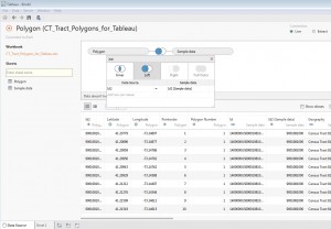

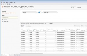

- Drag down on the Data menu, and from the carrot menu for the Polygons (CT_Tract_Polygons_for_Tableau) data source select Edit Data Source. Drag the Sample data sheet into the data workspace.
- Normally you will want to join the Polygon sheet with your data sheet using a Left join. Click on the venn diagram in the data workspace to bring up the Join dialog box. Click on the image illustrating Left join. The Polygon Data Source sheet should be joined to the Sample data sheet with the join clause Id2 = Id2 (Sample data):

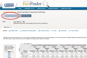

The link to this table from the American Community Survey can serve as a helpful starting point to browse for more data at the Connecticut Census Tract level. In the upper left corner, above the data, lick the Advanced Search button to return to the main American FactFinder search page. Note that ‘All Census Tracts within Connecticut’ will be pre-selected in the Your Selections window, and you can use the Topics menu to browse by topic among the more than 7,000 data tables available.

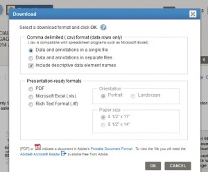

- Download the data in .csv format
Be sure to always download data in .csv format*from American FactFinder instead of using the ‘Presentation-ready’ Microsoft Excel format. The .csv format will swap columns and rows, presenting the data in a vertical format that Tableau will be happy with. (The ‘presentation ready’ format often brings the data into the spreadsheet as text, further complicating matters). From the Download icon above any table in American FactFinder, choose*Comma delimited (.csv) format (data rows only)*and leave the default settings*Data and annotations in a single file*and*Include descriptive data element names:The zipped folder will contain 4 files for each table; the metadata.csv file contains data about the table, and the larger of the 2 .csv files contains the actual data.
