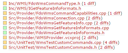

At face value, this commit looks innocuous enough, a few new files and some modifications. Nothing in the new and modified files that sounds like dangerous C++ code to my padawan-tier knowledge.
But looking at the overall list of files, something caught my eye. In this commit was a project file update, but it was only for windows (the modified WMSProvider.vcxproj file). Normally if new files are to be added, not only should the windows vcxproj file be updated as well (to include the new .h and .cpp files), but the corresponding Makefile.am files for Linux as well, and this was conspicuously absent.
This lit a light-bulb in my head, I had a look at the Makefile.am file for the WMS provider and lo-and-behold, it didn't have the new .cpp and .h files in this commit. Then it all came together.
The WMS provider was segfaulting because it was being compiled with undefined symbols (to the new FdoWmsGetFeatureInfoFormats class). Updating the Makefile.am with the missing files and re-compiling the WMS provider made the segfault go away.
