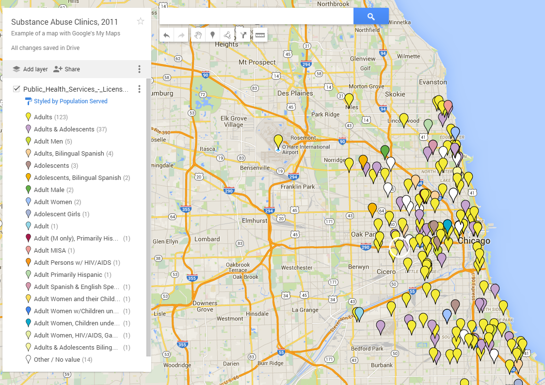

Next, we will symbolize the markers by "Population Served" or age groups that each clinic serves. You can also change the symbols for each class.
Google allows map creators to make changes to symbology.At this point, you will probably start to think about saving your project...But, Google has you covered as changes are saved as you go along. Be sure to give your map a good name, so it does not get lost among your other files.
You can even add a widget for people to get directions. Maps can be shared and permissions set with a few clicks after pressing the share button.
What the map looks like so far. Clicking on markers brings up attribute data.
