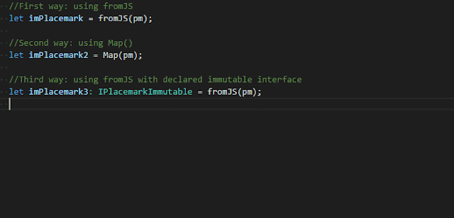

Now if we were to have a peek at what the inferred types are in any editor that supports TypeScript (for example, Visual Studio Code), we see that the default tooling experience is ... not very helpful
The first immutable object is inferred to be of type 'any'. The second one is inferred to be of type 'Map', which is close enough to 'any'. If you're working with objects of type 'any', you're pretty much back in vanilla JS land with none of the benefits that TypeScript offers. If an object's type or shape can be described in TypeScript, it should!

So is there anything in TypeScript that allows us to work with APIs such as Immutable.JS Maps in a more rigid and robust manner? Fortunately, I've found a useful little pattern that I've been using that makes working with immutable objects more TypeScript friendly and it involves leveraging 2 language features of TypeScript:
- String literal types
- Specalized overload signatures

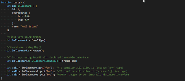

How this works is as follows:
- We define string literal types for each interface that contains the names of all the properties of that interface.
- In each complementary immutable interface, the get() method that returns 'any' is just a signature that closely matches the get() method of the original Immutable.JS Map. Because interfaces in TypeScript are just a compile-time means of enforcing and validating an object's "shape", it doesn't have to precisely match 1:1 with get() in Map. It just has to take a key and return some value, this interface type information disappears once everything is transpiled to JavaScript. This method signature is just the proverbial "foot in the door" to allow us to define specialized overload signatures off of it, we don't actually use this signature. By having the key be of a string literal type, it constrains our specialized overload signatures to only property names of the actual interface.
- Then it is just a case of filling out each specialized get() with the expected return type for the given property name. If a property is another nested object, you basically return its "immutable" equivalent interface.
And you will be prevented from accessing values with unknown keys due to the string literal type constraint.
