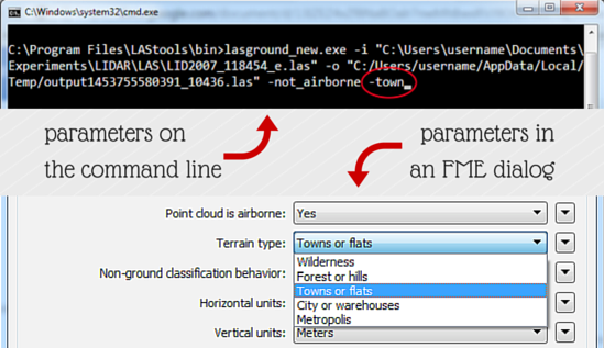

Using a tool on the command line vs. using a tool as part of an FME workflow.

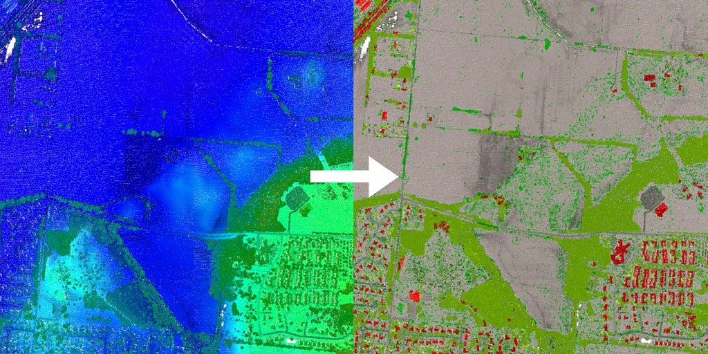

If you have a command-line tool that processes data in this way, create a custom transformer. Your custom transformer should collect parameters, use the FeatureWriter to save the data in the format expected by the tool, build and execute a command line, then read the processed features back with the FeatureReader. Learn how to do this.
This data was processed with the*LAStools functions lasnoise, lasground, lasheight, and lasclassify.

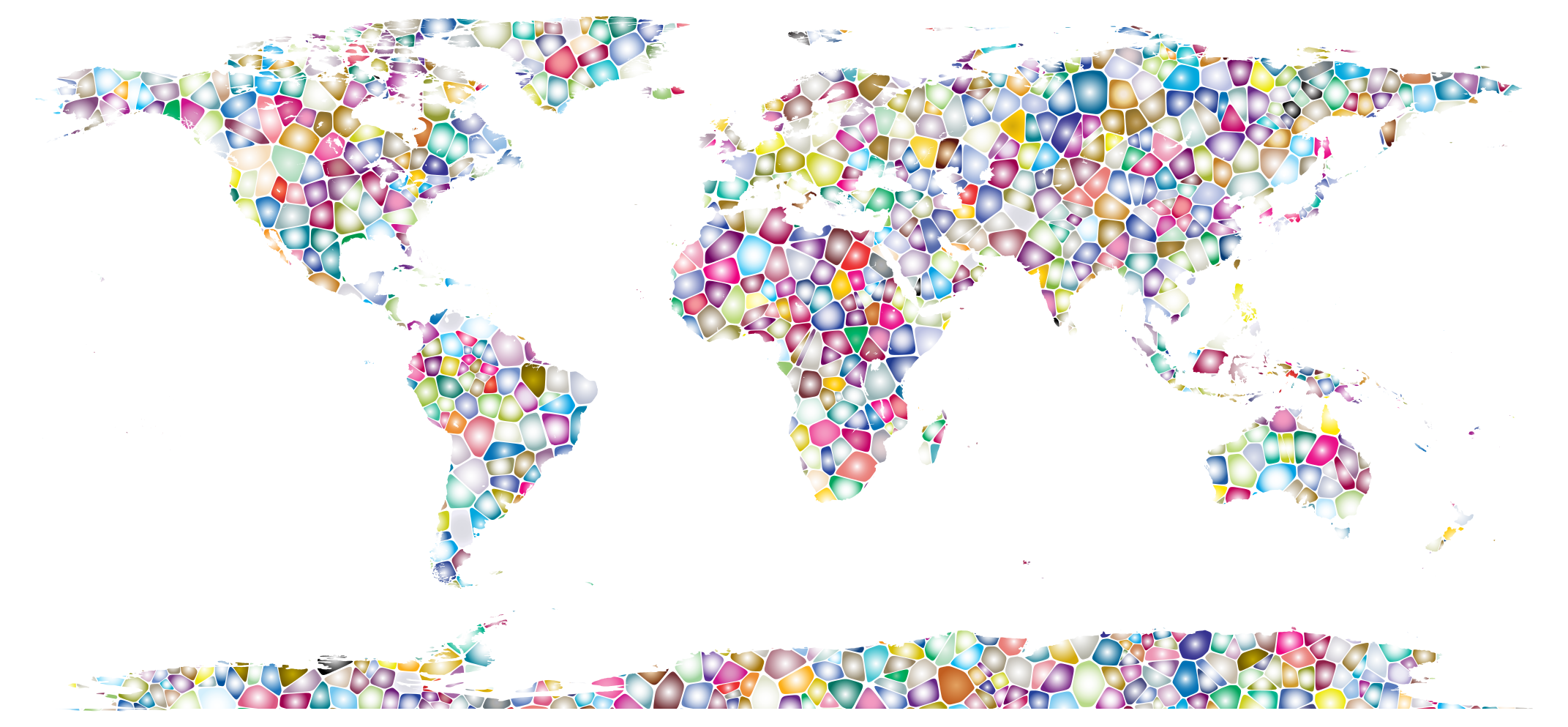

If you have a command-line tool that can read the format and save it as something FME can read, create a custom transformer that will act as a Reader. Your custom transformer should collect parameters from the user, build the command line and execute it, then use the FeatureReader to read the data created by the command-line tool. The data features will leave your custom transformer as though imported by any standard FME reader, and you can do any manipulation you want and write to any supported format. Learn how to do this.
This Candy World was created with the SVGReader, a custom transformer that leverages ImageMagick.

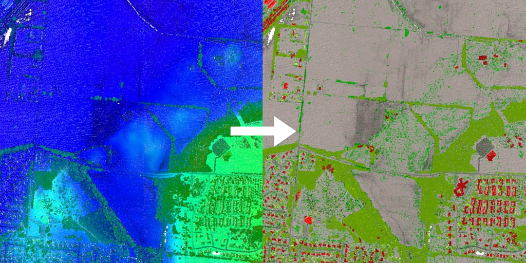

This data was processed with the*LAStools functions lasnoise, lasground, lasheight, and lasclassify.I want to read a format FME does not support.
