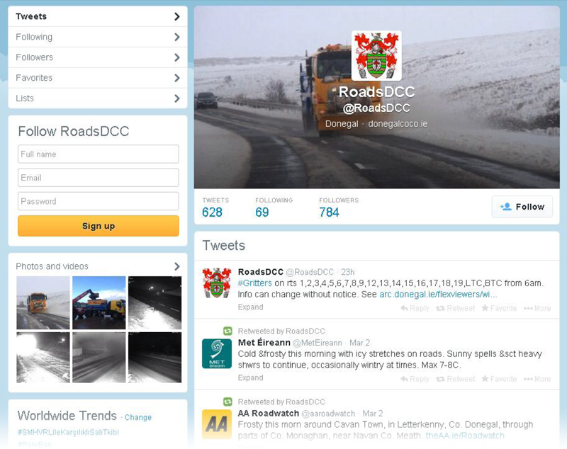

Donegal County started out with their first FME license in 2004 – and today in 2015, it’s considered essential software. And it was during a particularly stormy winter that their roads department wanted to communicate with the public about their nightly gritting schedule via Twitter. Maps weren’t part of the initial conversation, until Daragh heard about the idea and thought, “Hey… isn’t there something in FME for that?”
With a bit of manipulation, he was able to geocode the tweets based on parsed route numbers. The workspace generates a GeoRSS feed, which is available to the public on an online map, and shows them which roads will be gritted every night.
The aptly-named GritterTwitter workspace parses tweets, spatializes them, and produces a GeoRSS feed. Click to enlarge.
There was an unexpected benefit from adding the mapping component to the workflow. The tweets needed to be in a predictable format structure so that the route numbers could be extracted. The engineers doing the tweeting ended up with pre-defined tweets they simply re-use, rather than having to write them each time. In the end, says Daragh, “Everyone’s happy! The engineers are happy, the public is happy, and we have maps to communicate the information as clearly as possible.”
