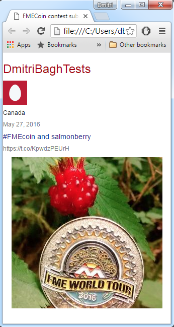

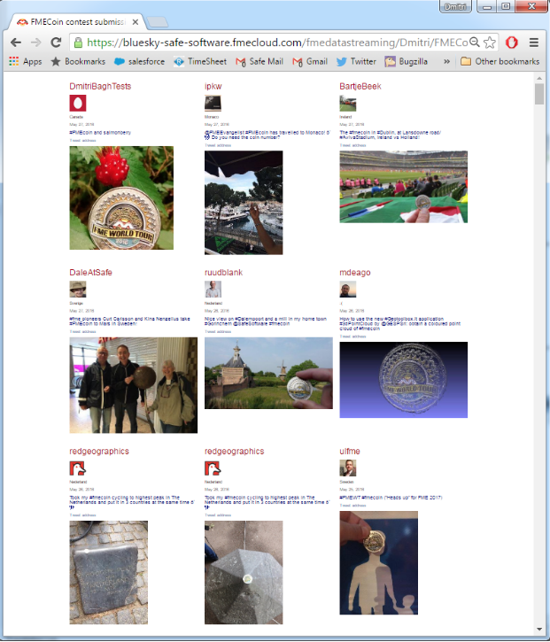

Picture gallery
A workspace for generating picture gallery uses two HTML transformers. HTMLReportGenerator creates multiple small HTML attributes, which, if we would save them as *.html file, will make nicely formatted web pages.*HTMLLayouter combines them into a grid.
This page is dynamic — in fact, it is a workspace hosted on FME Cloud that stream the freshest contents of our approved submissions database into your browser, grabbing images from my Dropbox and Twitter profile image repository.

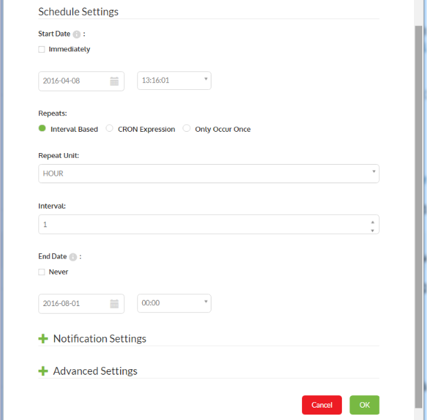

Automation: Enter FME Server
To automate this workflow, I uploaded all three workspaces to FME Cloud and set some rules for executing them. The submissions are checked once an hour. Now when the 16th minute of every hour approaches, I eagerly anticipate to see where else our users take their coins.
After receiving a notification, my colleague Robyn or I check the submissions and move them either to Approved or Rejected folders.
The Approved folder is under constant monitoring by DropboxWatch, a protocol that reports changes in Dropbox folders to FME Server.
I also created a subscription for this publication, which runs every time the Approved folder receives a new entry. The subscription runs the second workspace that moves the approved images to Archived and Published Dropbox folder and inserts a record into Approved Google Fusion table.
Finally, the Gallery workspace runs on*demand — that is, whenever someone presses the workspace link:

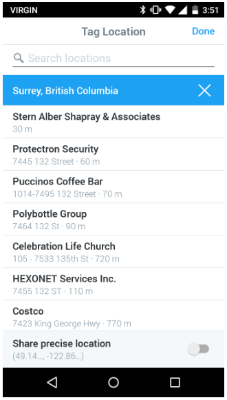

Tweet location
Tagging location on a tweet.To my embarrassment, it took me a while before I figured out how to correctly specify location in a tweet. I incorrectly assumed Twitter would use the coordinates from the images I submit — as a geographer, I always keep location functionality turned on in my devices.
No, with Twitter, I either can choose a named location from the list, or switch to sharing my precise location taken with GPS.
To my relief, a lot of people made the same mistake. Maybe, our advanced geographical awareness played a role in this systematic error, or maybe the location functionality is an unfamiliar feature to many Twitter users.

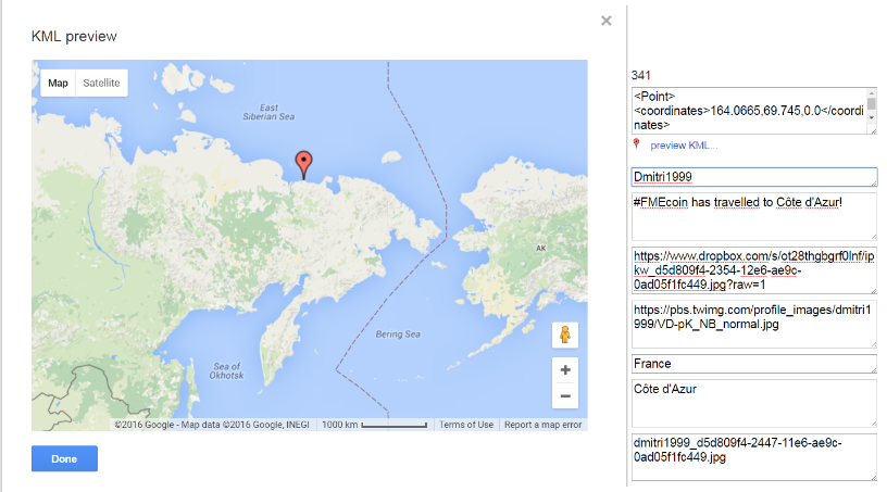

After some debates we decided to place the tweets with no location into Siberia. This generated a lot of jokes about coin repatriation adventures and misled tourists.
I am really sorry to disappoint you, but your travel agent might be lying to you about the tour you purchased.If I find the right location of the tweet based on its text or can get the coordinates directly from the users, I manually move the coins where they belong.

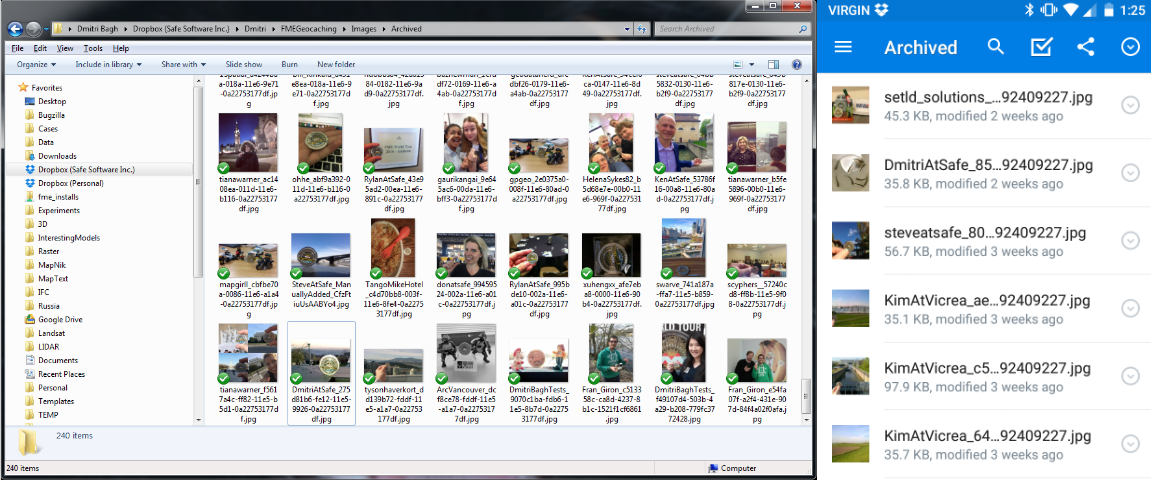

Dealing with images
After the success with Tweet ID, I didn’t hesitate to use Dropbox for storing images from the tweets. The body of the Twitter response has a link to the image, which I get with ImageFetcher, and, without saving to my local drive, I immediately upload it to Dropbox, which will take care of the rest —*the image will be addressable via https protocol:
It also will live on my desktop. And my laptop. And my iPad. And even my Android phone.
From the submissions folder we manually move files to either “Approved” or “Rejected” folders. The files moved to “Rejected” folder are retired, we don’t touch them anymore.
The files from “Approved” folder automatically go to “Archived” folder and the downsized versions are placed into “Published” folder. These are the images that we use on the map and on the report page. DropboxConnector lists all new submissions, copies files to new folders, and deletes the processed files. In this workflow, DropboxConnector is our main tool for physical manipulations with the files.

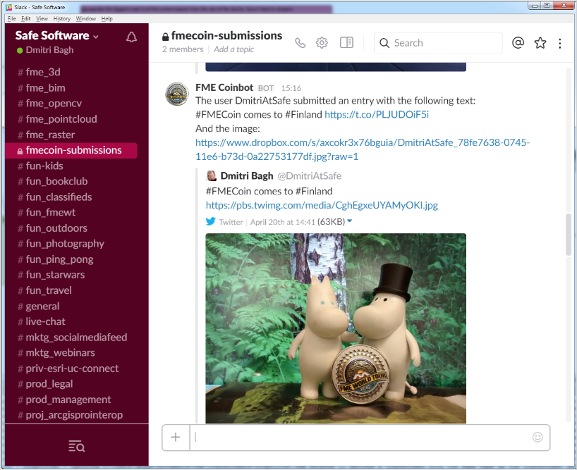

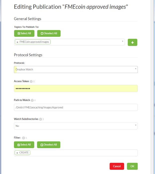

Slack notifications
The bot posts the text of the tweet and shows the image that comes with the tweet:
For us, it is a signal to go and make a decision whether to approve or reject the submission.
