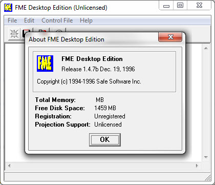

In 1993 (or should we say, approximately 12 million minutes ago) FME was created. It was a format translation tool with a small – but growing – number of Readers and Writers. The image to the right is the earliest known fossil evidence!

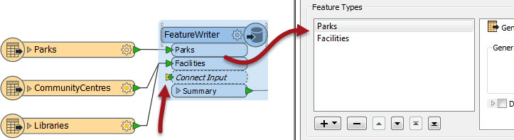

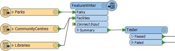

As you can probably guess, the FeatureWriter is a transformer that has all the parameters of a Writer and writes data:
The big advantage here – like in the screenshot above – is that you can carry on with more transformers after writing data. Previously you could use a shutdown script, or chain several workspaces together, but this is a far superior solution.

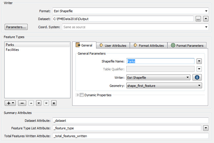

Anyway, the FeatureWriter parameters dialog looks like this:

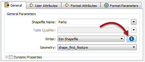

The top part of the dialog is obviously similar to the Add Writer dialog – it’s where you decide the format and output dataset, plus set any specific parameters. In the above example we’re writing Shapefiles to the folder C:\FMEData2016\Output (btw, did you notice we renamed the format from “Esri Shape” to “Esri Shapefile” to match what most folk in the GIS world apparently call this format!)
The middle part of the dialog is split into left and right parts. The left-hand side lists the feature types we have defined and lets us pick which on to deal with. Notice that the list is the same as the input ports we have on the transformer. In fact you can add new Feature Types by simply making new connections to the transformer:

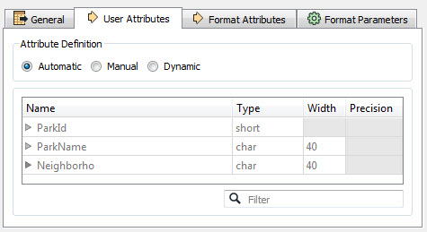

The right-hand side is like the feature type parameters dialog. It has the same tabs (General, User Attributes, Format Attributes, and Format Parameters). These should be almost identical to the proper Writer feature type dialogs, meaning you can set dynamic parameters and feature type “fanouts”. Here, for example, is the user attributes tab:
Automatic attribute definition is particularly useful here, as it automatically updates to reflect what information is being connected to it.

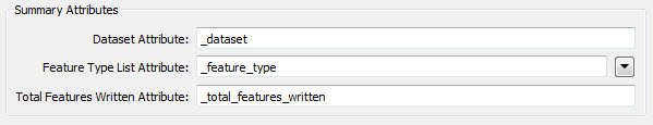

The bottom part of the FeatureWriter dialog deals with the output from the transformer, in terms of information about the writing process:
The attributes defined here contain the name of the dataset written, the feature types written, and the number of features written. Since we can do further transformation after the data is written, it makes sense that we’ll want to know this sort of information. For example we could pass the list of feature types to another transformer to work with, here an FTPCaller:
Notice in the above how the list of feature types is exploded, and then used in the FTPCaller to define the files to be uploaded.

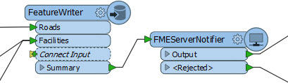

FeatureWriter and FME Server

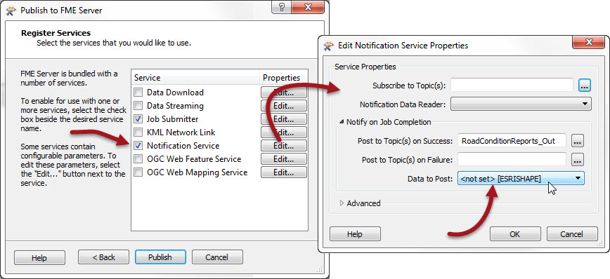

FME Server is all about automation and so chaining workspaces together (or wrestling with Python) is a common way to automate a series of steps interrupted by writing data. For that reason the FeatureWriter is likely to be even more important than on a Desktop environment.
Another automation method is notifications, and you might also be able to do away with some of those. For example, when you publish a workspace to FME Server, you can choose to register it with the notification service and set a Writer to provide content to post to a topic:
That same dialog won’t let you pick data written with the FeatureWriter. Is that a problem? No! With the FeatureWriter you wouldn’t need to do that. You could just follow up the FeatureWriter with an FMEServerNotifier transformer:
This is a great example of how our workspace design will change as we start to use the FeatureWriter. Thanks to De Wet for pointing it out to me.

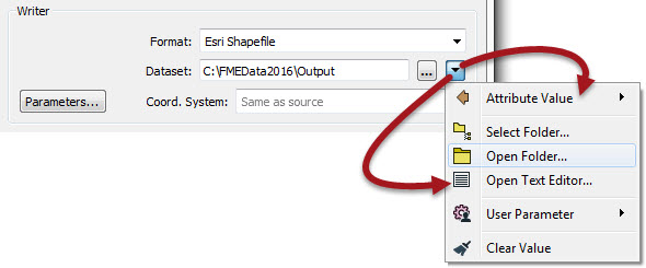

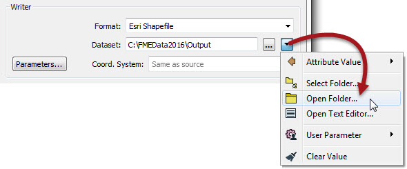

Open Folder
The dataset parameter has an option equivalent to “Open Containing Folder” on a Writer:
We may also add this to the context menu for the transformer itself, which would be useful.
