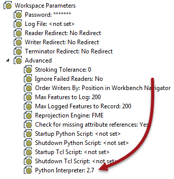

Python Updates
Up until now FME has supported Python versions 2.x. FME2016 introduced support for versions 3.4 or greater. In particular for 2016 the changes were:
FME has shipped with v2.7 for a long time, so the 2.6 deprecation shouldn’t be a problem, and because we’re not dropping v2.x completely you don’t have to worry about suddenly upgrading all your existing scripts. Python version 3.4+ introduces new functionality (which is great) but in a way that is not compatible with v2.7. That’s where the FME compatibility parameter (located in the Navigator window) comes in:
This parameter isn’t so much picking the interpreter to use – there’s an FME option to do that – but more you telling FME which version of Python your scripts are compatible with. There are three options:
If you pick 2.7 then you are telling FME that scripts in your workspace are only compatible with v2.7. If you pick 3.4+ then you are telling FME that scripts in your workspace are only compatible with v3.4. If you pick “2.7 or 3.4+” then you are telling FME that your Python is compatible with either version. In all cases, of course, it’s up to you to ensure that your scripts really are compatible with the version specified.
FME then picks the interpreter automatically. It will first check the FME option (Tools > FME Options > Translation) to see if that interpreter version is compatible with your script. If not it will search your system for a suitable interpreter using the PATH environment variable. The full information is available under this help page.
The compatibility parameter is workspace-based; i.e. it applies to each workspace individually, so that one workspace might be compatible only with v2.7 while another might be compatible with 3.4. Of course this is most important when you intend to share the workspace, or run it on FME Server. In that case “2.7 or 3.4+” is the most flexible option because it will run on a platform regardless of what interpreter it has.
If you set it to 3.4 but publish it to a platform that only has a 2.7 interpreter, then the workspace will error out with the complaint that it can’t find an interpreter.
The FME Objects and FME Plugin APIs don’t yet support Python 3, but that is planned for FME2017.

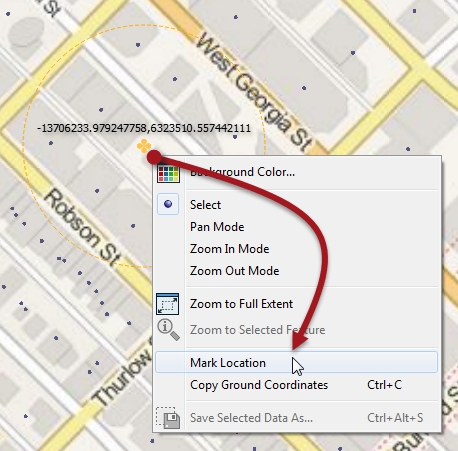

*Data Inspector: Mark Location
The Data Inspector got a nice new update in 2016 with a Mark Location option. You can find it by right-clicking like so:
You might have noticed that already. But did you notice the Mark Location option on the toolbar? If you click that you get a bunch of options for that marker:
With that dialog you can place a marker at specific coordinates, plus also change the color, marker type, label, and symbol. The marker persists too, so open a new dataset in a new tab, and you’ll get the same location marked as in a previous tab. It’s a really very useful piece of functionality when inspecting data and – in particular – bookmarking a location to go back to later (click the Locate button and the display moves straight to it).
This is probably about the last bit of functionality that existed only in the old FME Universal Viewer application, and not the Data Inspector. In fact, you may not have noticed but the FME Universal Viewer no longer appears in the FME start menu. It’s like saying a sad goodbye to an old friend (albeit one I haven’t seen in five years).

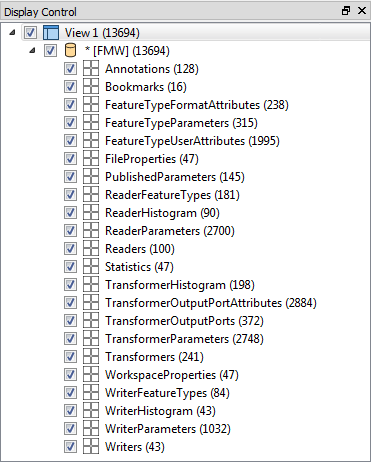

Workspace Reader
This Reader is a new format, but it’s one that simply reads other FME workspaces and provides information about them. For example, if I use this Reader to read all the fmw files in the FME training course, I see this:
I can see (from FileProperties) that there were 47 workspaces, and that table shows me their name, when they were created, and even when they were last run. I can see I have 100 readers in those workspaces, and can look to see what they are. I can even see how many bookmarks I have (not enough).
The nice part is that these tables all have keys to join them – for example workspace_id and reader_id – so I can find which feature types are used in which reader in which workspace. The only question is why would I want to do this?

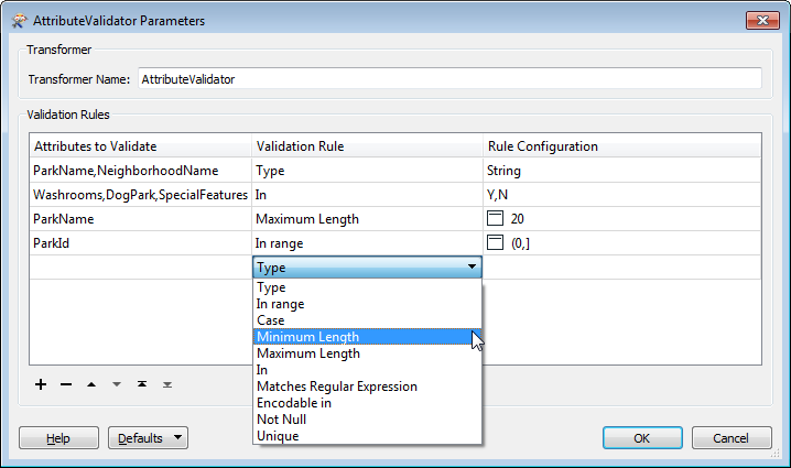

AttributeValidator Transformer
The AttributeValidator is so explanatory – in both name and functionality – that it probably didn’t need a full blog article anyway. It’s just more important for you to be aware that this exists, so that you can try it yourself. For what it’s worth, the parameters dialog looks like this:
You can see that there are a number of tests that can be carried out on attribute data. It’s perhaps not anything you couldn’t already do with a variety of other transformers, but has the advantage of handling multiple attributes and multiple tests in a single, convenient interface. For example, in the above image both ParkName and NeighborhoodName are being validated against the Type rule.
So try it out and watch how this transformer makes your workspaces more compact than before. I’m guessing it will replace the Tester in certain scenarios, and be easier to use too. If you want to see the above example being demonstrated then check out the Deep Dive webinar that Dale and I presented earlier this year. There’s also a great YouTube video demo from Stirling Geo.

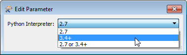

Python Updates
- Added support for Python 3.4+
- Deprecated support for Python 2.6
- Added a compatibility parameter to Workbench

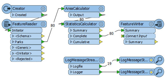

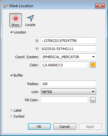

LogMessageStreamer Transformer
Guy Kawasaki says a technical evangelist always tells the truth, so I’ll be honest and say that this transformer was a great idea… but it has a big limitation.
The great idea is that the transformer extracts messages from the current log file/window for use in the workspace itself. We noticed that users often scan the log after a workspace has run, in order to determine if it ran correctly or whether any problems occurred. With this transformer the same workspace can both carry out processing and scan the log!
When I tried this out I used a workspace with FeatureReader and FeatureWriter because I want to write my data before I examined the log:
But that’s where I hit this limitation: there is no control over when LogMessageStreamer transformer operates. In my workspace it started and finished before most of the transformers were executed. I got 19 messages from the log, which covered some of the reading, but none of the transformation or writing.
So, this transformer might be useful to you, or it might not. If you’re into parsing FME logs, try it and see if it can help you. Then give us some feedback so we can see if anyone is using it and whether it was useful.
