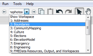

As you can see, the bookmark navigator is a drop-down list of bookmarks with a backwards/forwards navigation arrow.
The idea is that you divide your workspace into sections using bookmarks, and then flip from one to the next using this tool. That way it’s both easier to navigate a workspace while presenting, and easier to see the workspace as an audience member (because FME zooms into each section automatically).

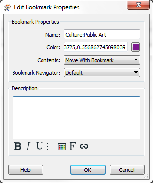

Firstly, double-click a bookmark header and you now get this dialog:
This by itself is a great improvement. If you remember, bookmark descriptions were edited separately to the bookmark color and name. Now it’s all in one dialog, which is very useful.
But also notice the Bookmark Navigator parameter. There are three possible values:
Include means that you want this bookmark to be used in the Bookmark Navigator and Exclude means you don’t want it to be there. That’s great for controlling what you get to show in a presentation. Default depends on the bookmark itself. If it is a plain bookmark, then by default it will be included. If it is a bookmark nested inside another, then by default it will be excluded.

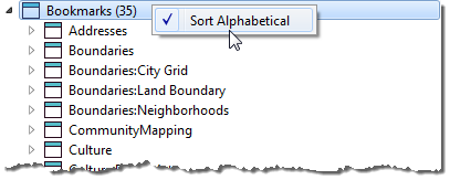

The order of display for bookmarks is controlled in the Navigator window. If you right-click on the bookmarks header you’ll see that the default order is to sort alphabetically:
But click on that option and alphabetical sorting is turned off (notice in the image below that the icon for bookmarks changes to show that):

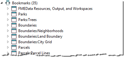

At that point you can reorder bookmarks by simply dragging one above (or below) another. Above I’ve moved FMEData Resources to be the first bookmark to be displayed, followed by Parks, Park:Trees (a nested bookmark), Boundaries, etc…
Because I want Park:Trees to appear I also changed its display mode from Default to Include. Otherwise, as a nested bookmark, it wouldn’t appear.

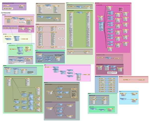

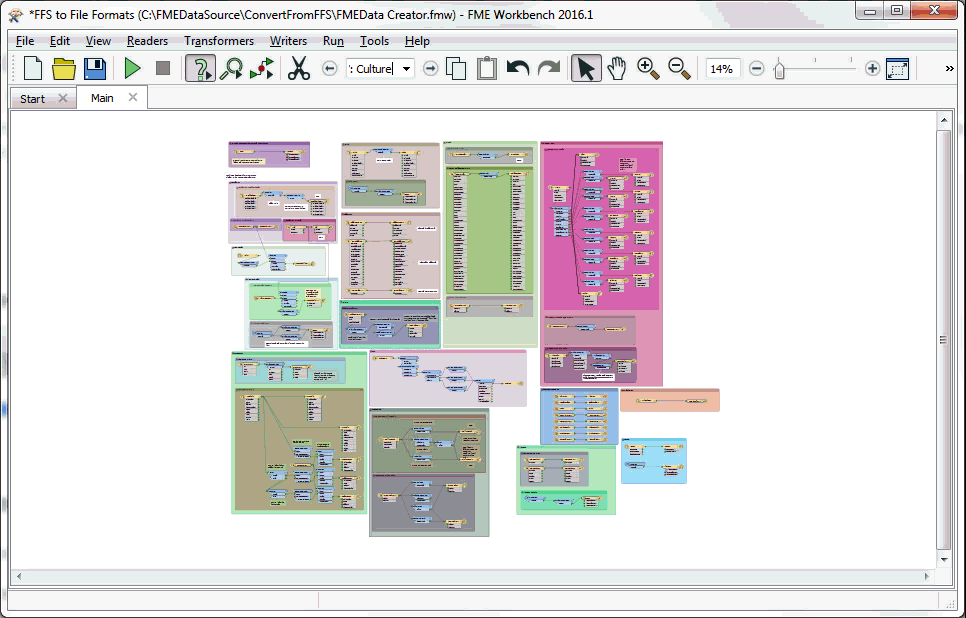

Secondly, if you do have a large workspace, one that maybe looks like this:
…you’ll be able to navigate through way easier with this new tool. You don’t even have to set the display order and the shortcut key lets you avoid the Navigator window altogether.
