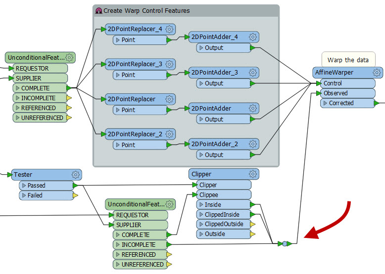

Say, for example, I have this workspace (click to enlarge):

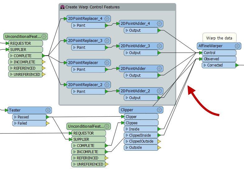

Notice the ugly overlapping connections into the AffineWarper:Observed port. I could move the AffineWarper transformer further down the canvas, but then the connections into the Control port would be equally messy. But I can easily clear this up with a Junction:

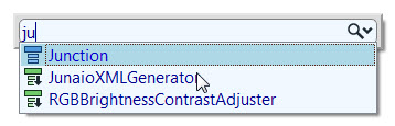

Like I said, it’s a way to pull together unorganized connections. “But how do I add this miracle junction,” you ask. Well, that’s simple too. Because a Junction is just a transformer – albeit one with a very small representation – you can add it with Quick Add or the Transformer Gallery just as you would with any other transformer.

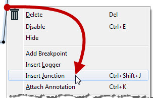

Additionally, you can right-click an existing connection and there is an option to Insert Junction:
…plus there’s a handy shortcut key (Ctrl+Shift+J). So now there’s no excuse for overlapping connections. And as we’ll see, even if overlapping connections were unavoidable, with hidden connections you’ll be “in the clear”!

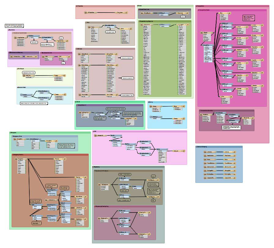

We’ve all had one of these workspaces; the one where there is one (or more) long connection cutting through the core of the canvas. Often it’s where a section of workspace early in the translation provides the input for multiple other sections, like this example:
With that structure it’s impossible to reorganize the transformers in such as way as to avoid overlaps completely. In 2016.1 – while I can’t avoid overlaps – I can tidy the workspace by hiding them:

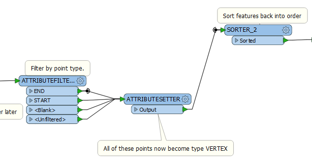

Well, you know there’s a connection, because each end is now represented by a small icon:

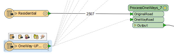

And clicking on the transformer (or feature type) itself reveals the hidden connections that are there:

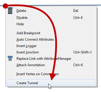

If there is a problem with hiding connections, it’s probably that they are not always easy to see, even with the little icon. You also can’t manipulate or edit them without making them visible first. So what we did was combine hidden connections with junctions to come up with a tool called tunnels.
As you can see, not only do connections have an option to hide them, they also have an option to create a tunnel:

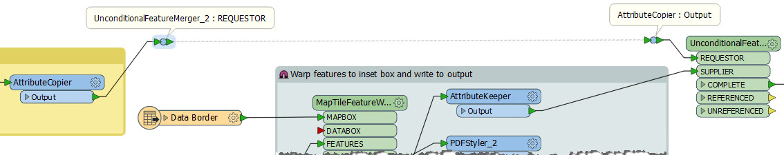

Yes! A tunnel is a combination of Junction/Hidden-Connection/Junction!
Notice that I have a hidden connection, but there is a junction (with annotation) at each end. Now I can move the junctions to manipulate the hidden connection and both the junction and annotation are a much better visual clue as to what is happening.

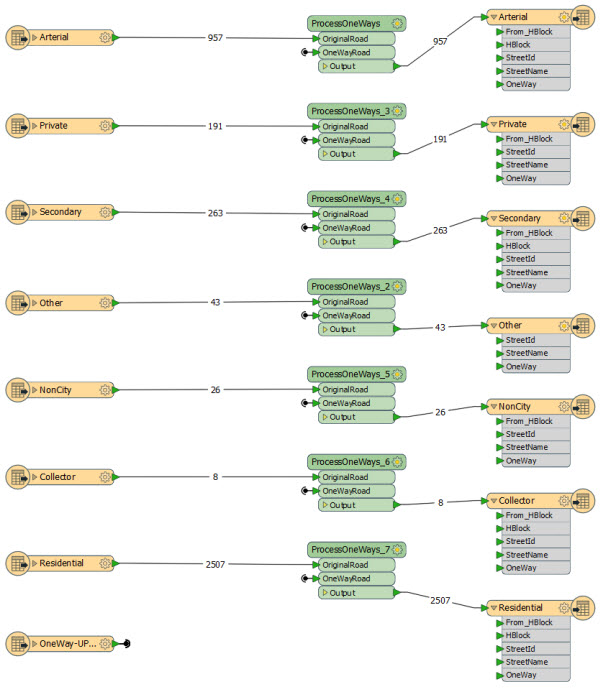

Let’s say there are various locations in there in which errors might arise. If I want to direct those errors to a single Logger transformer, say in the bottom right of the workspace, then I’ll have connections all over the screen. But instead I can just hide all those connections and put the Logger wherever I like:

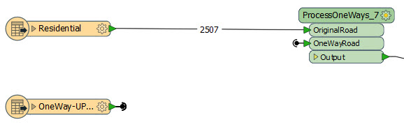

In that example it didn’t matter much whether I used tunnels or plain hidden connections. But in another scenario it is more important: when there are multiple connections emerging from a port. See this example:
There I have a hidden connection, but it’s really unclear what that connection is. The situation becomes much more clear when I use a tunnel instead:
