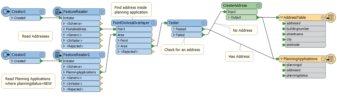

Take a look at this workspace (click to enlarge):
First I’ll explain what it does.*Basically it reads new planning applications (i.e. polygons on which development will take place) from a CAD file and writes them to a corporate database. It also determines which address is associated with each*application by doing a point-in-polygon test (PointOnAreaOverlayer transformer). If no address falls inside the planning application, then one is created and added to the address table.
Simple, right?
The Problems
There are two problems in this workspace that relate to the order of features.
Firstly there are two*Creator transformers, each of which triggers reading of data. If I want to use the Areas First parameter in the PointOnAreaOverlayer then I need to make sure the areas are actually first, i.e. Creator2 executes before Creator1.
But how can I do that?*Traditionally it would be near impossible to tell*in which order features would be created and processed. You could set Creators to execute*either before or after Readers, but you couldn’t set the order in which each Creator was executed.
Secondly, look closely at the output schema. Notice I am writing to a database where the planning application table uses addressid as a foreign key. What you can’t see is a constraint on the table that addressid must match a record in the address table. In short, when creating a new address I need to write the address first, before I write the planning application that references it.
But, again, how can I do that? There are*multiple connections coming out of the CreateAddress custom transformer and no way*to tell which order the connections will*fire.

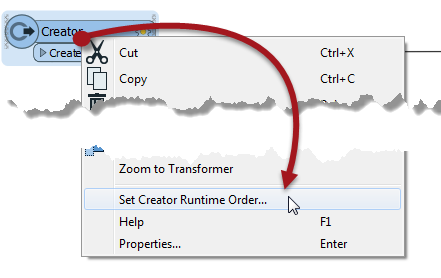

Creator Order

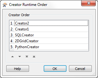

Right-click on a Creator in 2016.1 and – assuming there are two or more Creators in the workspace – there is now an option to Set Creator Runtime Order…
This opens up a dialog that lets you adjust the order in which Creators are executed:
Notice that this doesn’t just apply to “Creator” transformers, it also applies to the different forms of that; such as SQLCreator, 2DGridCreator, and PythonCreator. Basically any transformer that has an output port but no input (yes, the Player transformer is included in that).
Combined with the Creator “Create at End” parameter, I could even set up a Creator-Reader-Creator sequence in my workspace.
Setting the order in which data is created will be a big benefit in many scenarios. As with the above workspace, it is going to be particularly*important as we switch focus from Readers to Creators/FeatureReaders, because it effectively lets you set the order of those FeatureReaders.
In my*workspace above I can ensure that Creator2 is the first to execute, meaning that FeatureReader2 reads its data first, and that*I can confidently set the Areas First parameter in the PointOnAreaOverlayer.

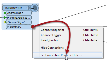

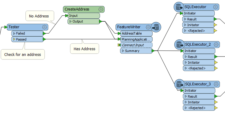

The other issue was connection order. In 2016.1, where there are multiple connections issuing from an output port, right-click on one of them (or on the output port itself) and you again have the option to set their order:

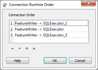

Like the Creator transformers, the dialog lets you order the connections connected to that port:
In this*screenshot I’m setting the order in which I trigger connections to SQLExecutor transformers – but it doesn’t always have to be for databases or to the same transformer type. This is functionality that you could use almost anywhere in a workspace.
In my workspace above*I can force the address connection (from CreateAddress:Output to AddressTable) to be triggered before the planning application connection. This means*that*address features get*written first and the foreign key constraint is satisfied.
NB: One requirement*for*my specific example is that my address records need to be ‘committed’ right away, not just ‘written’. To ensure that happens*I would set the transaction interval to 1 on my database writer. That way each address is committed as soon as it is written.

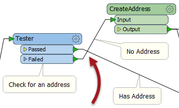

The other reordering I can do is that of the ports on a transformer. Did you notice that nasty overlapping connection in my workspace?
I could avoid that by reorganizing my workspace so that the CreateAddress custom transformer is lower down the screen. But in 2016.1 I can simply switch the order of the output ports on the Tester transformer:
With that right-click I can move the port up or down, uncrossing my connections. The same behaviour is available on both input and output ports.
Simple, right?
The Problems
