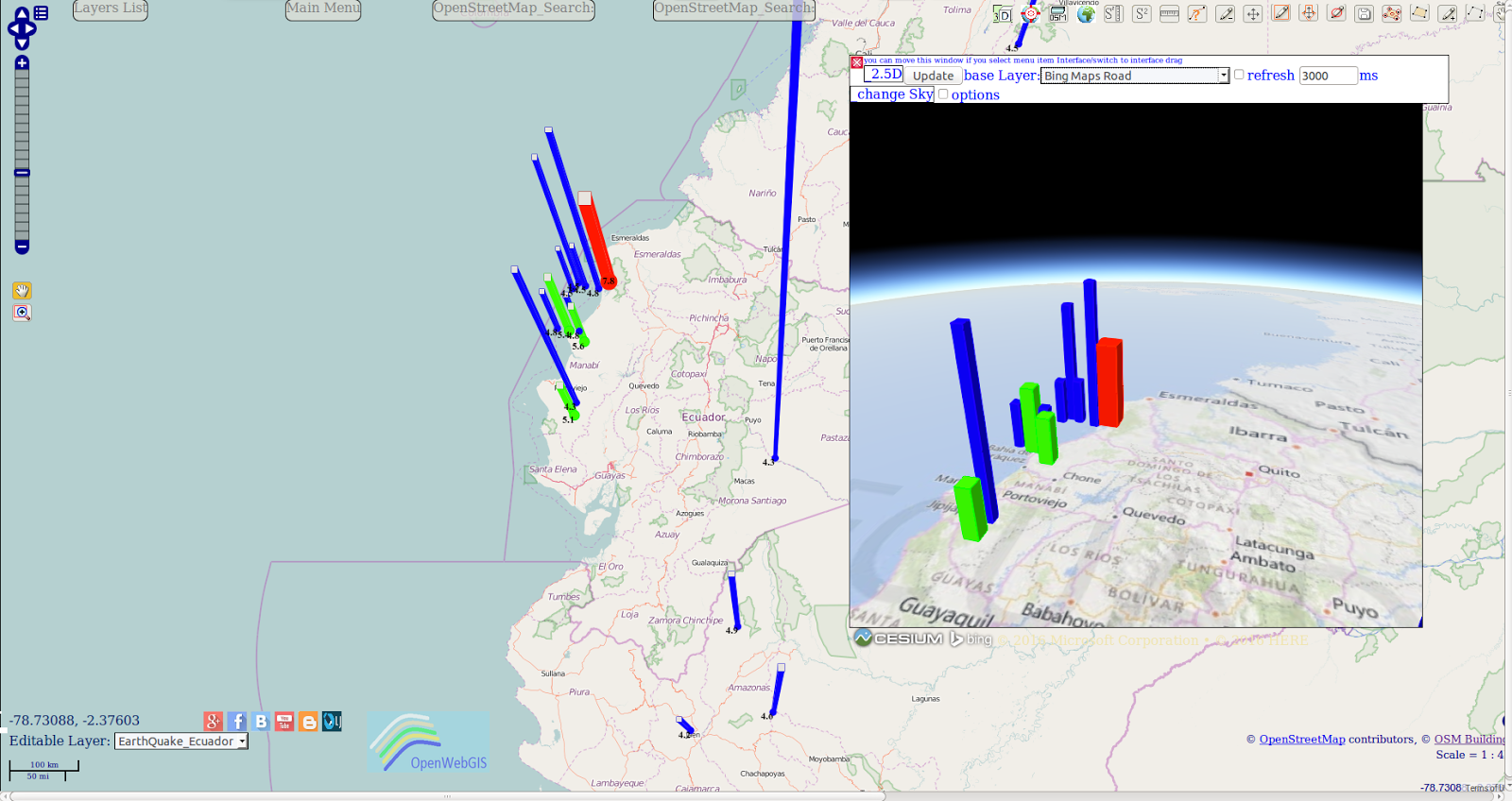

Figure 3 - The chart of changing magnitudes by timesTo make 3D map of earthquake depth you must click on the button :
in the upper right corner of the map. This button has the title "Add 3d Map. Globe ". There will be a pop-up window in which you can set the desired size of the 3D map area in pixels (see the result on Figure 4).
Figure 4 - 3D map of earthquake depth in Ecuador on 17 April 2016
The map shown on Figure 4 is available at this link.
