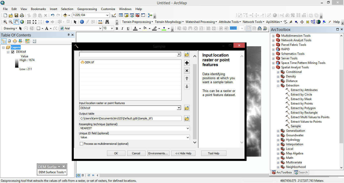

First we need to convert the DEM grid into elevation points.
1. Spatial Analyst Tools toolbox / Extraction toolset >> Sample.
DEM Sampling
2. Specify dem 30m as the input raster and as the input location raster, pnt30m_table.dbf as the output, and NEAREST as the resample technique.
3. From the ArcMap Layer Panel, right-click on pnt30_table.dbf and select Display XY Data.... Make sure x is in the X field, y in the Y field, and dem30 in the Z field.

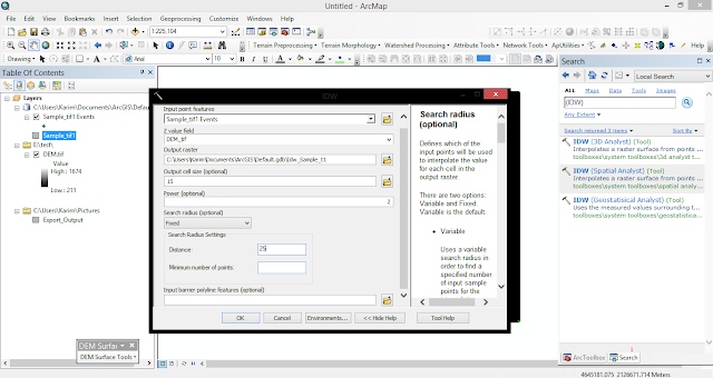

5. Use the spatial interpolation techniques to generate DEMs from the point data set we just created. The first method we use is Inverse Distance Weighted (IDW).
DEM Interpolation

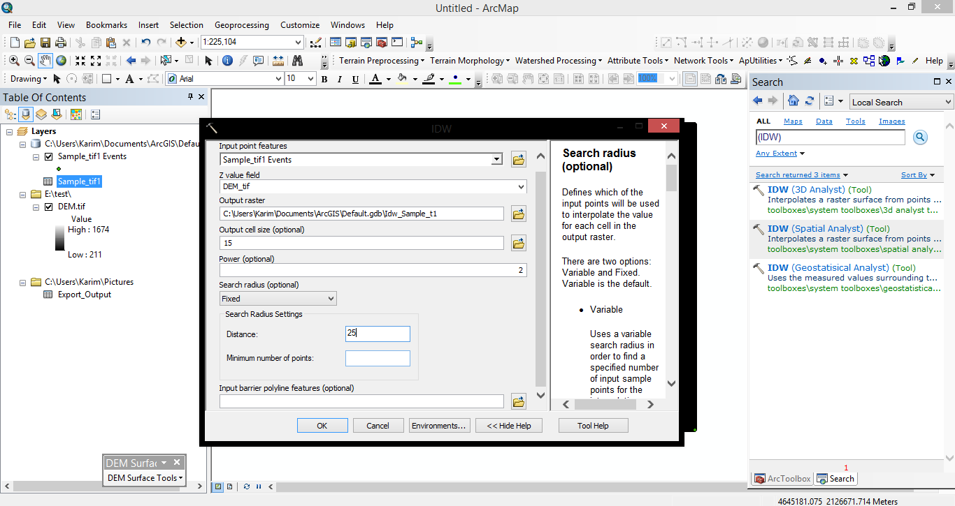

ArcToolbox/Spatial Analyst Tools/Interpolation.
DEM Interpolation
