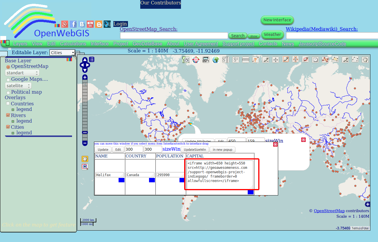

Let's add a website and set the width and height of the cell where it will be opened as it is shown in Figure 4.
Figure 4 - Result of adding website in editable cell.
Click the "OK" button and get the result shown in Figure 5. Click on the button "Update" in the window shown in Figure 5, and the inserted websites and video will look as it is shown in Figure 6.

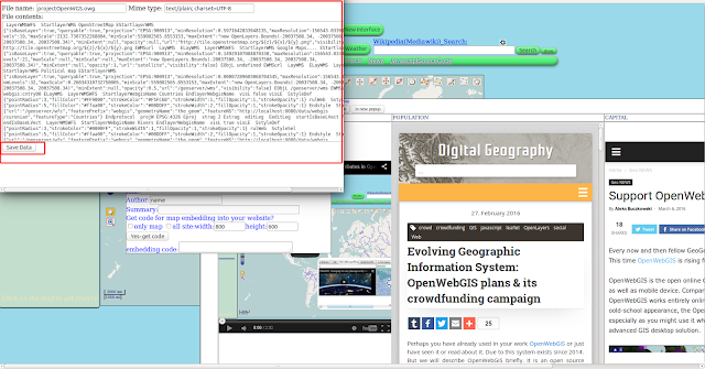

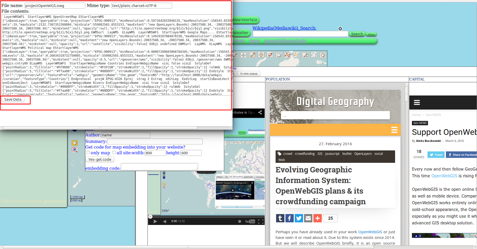

Then a window will open with the contents of a text file, to save it on your disk, click "Save Data" (See Figure 9).
Figure 9 - To save contents of a text file on your disk, click "Save Data".
An example of such a file you can download from this link (Google disk). To use it in OpenWebGIS you need to download it via the menu item "Project->Load project file".
