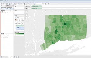

The Connecticut State Data Center has converted a number of U.S. Census Bureau TIGER/Line shape files into polygon data files for use in Tableau, including polygon* files for Connecticut towns, school district, Census tracts, and legislative district boundaries. If you would like to visualize Connecticut town-level data on a map (as in this dashboard) in Tableau, this Excel workbook of Connecticut town polygons contains a Polygon spreadsheet that will render a map of Connecticut towns in Tableau, and an additional sheet of town tax mill rate data that you can link with the polygon map (following the steps below, to create a choropleth map like this (click image to see full size):

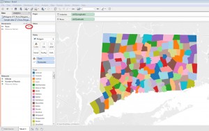

- If Pointorder appears in the Measures pane, it must be converted to a Dimension – simply drag it from Measures to Dimensions. Then, drag Pointorder to Path on the Marks card. (Don’t panic, it is normal to see a strange Rorschach test-like image on the map at this stage! Until we tell Tableau that we want Town to be the level of detail, it’s plotting the average latitude/longitude of each Pointorder value for all the rows in the data set, resulting in a bizarre polygon approximately where Madison is).
- Drag Town from Dimensions and place it on Color on the Marks card. (Select Add all members in the dialog window).
You should now see the outlines of all 169 Connecticut towns (click the image above to see the full view) and you can now* link or join this base map to other data following steps in either Option 1 or Option 2 below.

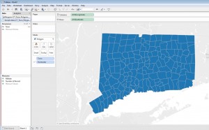

- * In the map above, Town is on Color on the Marks card. We want to create a choropleth map based on the Millrate measure, but we want to keep Town in the visualization, letting Tableau that town is the unit of analysis or “level of detail”. Move Town from Color onto Detail on the Marks card. You should see a the outline of the state but the state is changed to a solid color.
(If you like, you can show the borders of the towns as in the image above by selecting a Border color from the Color menu on the Marks card: Click Color, then under Effects change Border from Automatic to a color. This step isn’t necessary, but illustrates that Tableau really is showing the individual towns at this point) - Now drag the measure you want to show on the map, e.g. Millrate if you’re using the Sample data, to Color on the Marks card.

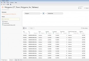

- Drag down on the Data menu, and from the carrot menu for the Polygons (CT_Town_Polygons_for_Tableau) data source select Edit Data Source. Drag the Sample data sheet into the data workspace.

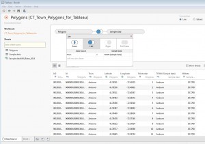

- Normally you will want to join the Polygon sheet with your data sheet using a Left join. Click on the venn diagram in the data workspace to bring up the Join dialog box. Click on the image illustrating Left join. The Polygon Data Source sheet should be joined to the Sample data sheet with the join clause Town = Town (Sample data):
