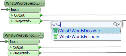

what3words is supported in FME by a couple of transformers; the What3WordsEncoder and What3WordsDecoder. The encoder turns spatial positions into a what3words sequence; the decoder turns a what3words sequence into spatial features.
Because they are on the FME Store, you obtain the transformers by simply typing their name into Workbench (Quick Add). They should be available for both FME2015 and FME2016.
Both transformers require a what3words API key, which you can get by signing up on their web site (it’s a two minute task).
NB: Once you’ve put your API key into the transformer, use the button to save that as the default parameter value – then you won’t be searching for your key whenever you want to use it!

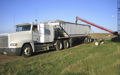

My wife works as a dispatcher for a trucking company in an agricultural area of Canada. The company picks up grain from farms and delivers it to grain elevators for shipping.
Dispatching trucks has the issue that farms rarely have a meaningful address. Traditionally farms are identified by a legal description based on the Dominion Land Survey; for example (thank you Wikipedia) a farmer might live at SE-12-20-33-W1 (South East quarter of Section 12, Township 20, Range 33, West of the first meridian)!
Plus… even if the farmhouse had an address, it doesn’t follow that the grain silo is at the same location; farms in Canada tend to be several hundred acres in size. So collection could be a long way from any single address point – or you might be picking up directly from the field itself as the crops are harvested.
So the problem is how to define pickup locations and transmit that information to a truck driver.

Here’s a scenario I’ve been mulling over for a while.
I don’t have a definite solution, but I reckon what3words – with the bonus of a little FME Cloud automation – would do the trick; something like the following:
